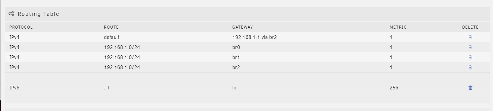

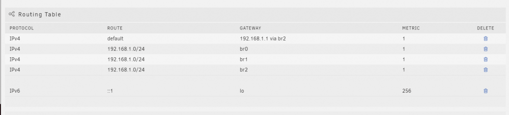

I've been running into an issue after upgrading to 6.7.2 . Where br2 becomes the default route.
The issue with this is that I don't have anything plugged into br2. I am currently only using br0, because it is my 10G link. br1, and br2 are only 1G links. So, I really don't want to use them.
I was able to fix this by modifying the route table manually. However, if I modify it manually after a reboot it reverts right back.
The weird thing is also if I downgrade back to 6.6.7 I don't have this issue.
So, my primary question is what is the best option for making the br0 route persistent across reboots?

Ok, so I sort of figured it out. If I turn off bridging on eth1, and eth2 then leave it on, on eth0, then bridge them all together it seems to work correctly.
# Generated settings:
IFNAME[0]="br0"
BRNAME[0]="br0"
BRSTP[0]="yes"
BRFD[0]="0"
BRNICS[0]="eth0 eth1 eth2"
PROTOCOL[0]="ipv4"
USE_DHCP[0]="no"
IPADDR[0]="192.168.1.253"
NETMASK[0]="255.255.255.0"
GATEWAY[0]="192.168.1.1"
DNS_SERVER1="192.168.1.254"
DNS_SERVER2="192.168.1.1"
DNS_SERVER3="1.1.1.1"
USE_DHCP6[0]="yes"
DHCP6_KEEPRESOLV="no"
SYSNICS="1"
If someone has a better way to do this than bridging ports that aren't even plugged in I'm all ears. However, it does look like doing this does seem to persist after reboot.
