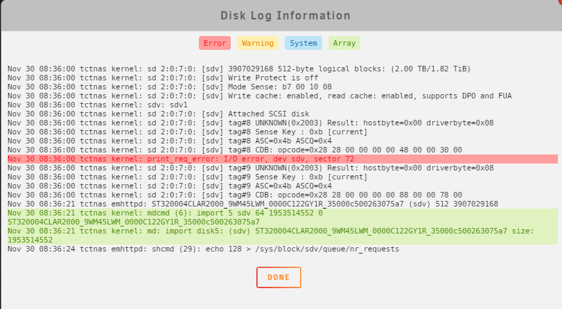

I went to preclear the replacements, but both drives did not show up. So i checked the disk log.

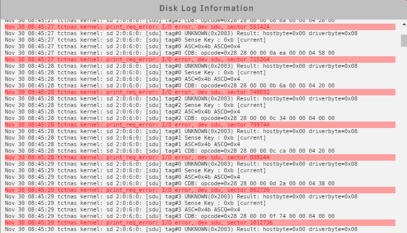

The replacements and several others are reporting:
Nov 30 08:36:00 nas kernel: print_req_error: I/O error, dev sdv, sector XX
The replacements are spamming this message. the others only have one entry.

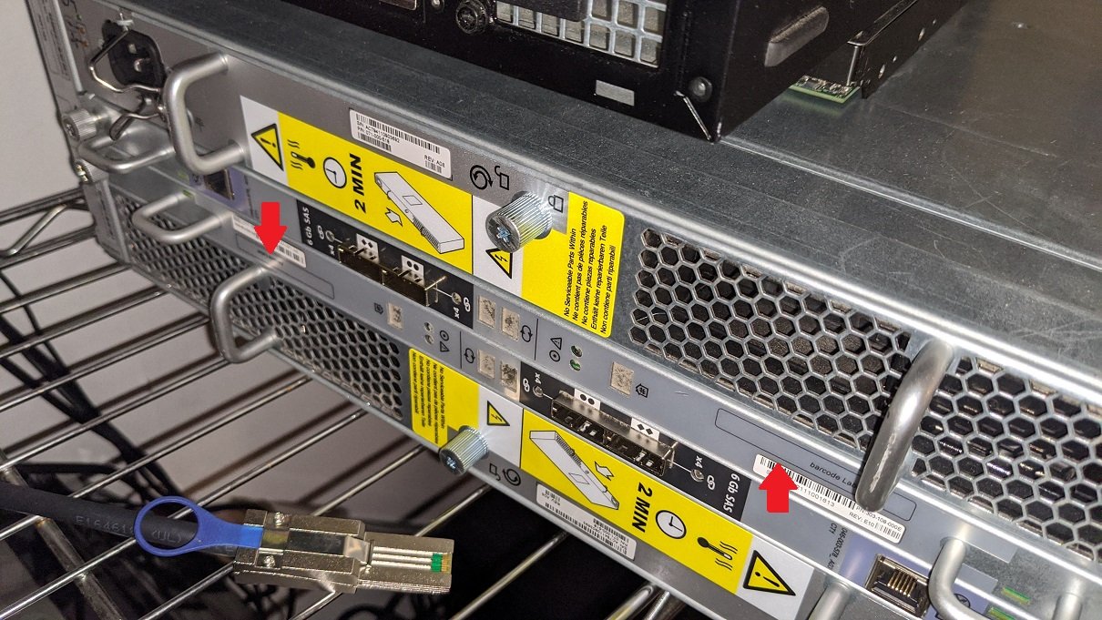

My DAS is an: EMC2 KTN-STL3.
I guess my two options are:
  • replace the interposers which are sending out read errors
  • replace the sas controller
my primary concern is the prevention of data loss.

I blew out the das, swapped the sas controllers, replaced the 8088 cable.
only five minutes in, but no more read errors on anything!!!!
w00t w00t. Probally the 8088 cable.
