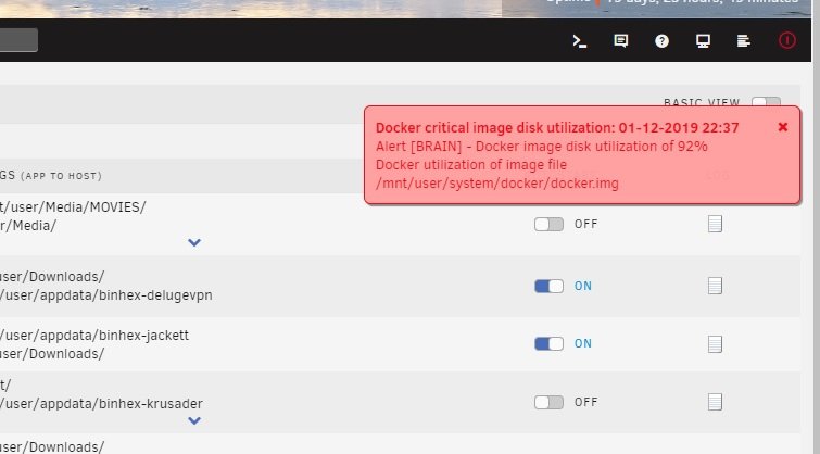

   I am new to Unraid and i am trying to find a way to make my docker image larger but i don't know where or what to do i keep getting this red error. i have attached a picture of what the problem is, any help is appreciated.
Making it larger isn't the solution. You almost certainly have one or more of your applications writing to a path that isn't mapped.

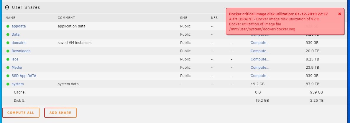

Your system share is on the array instead of on cache where it should be. That isn't the cause of your problem but it is something we can fix along the way to fixing your other problems.
