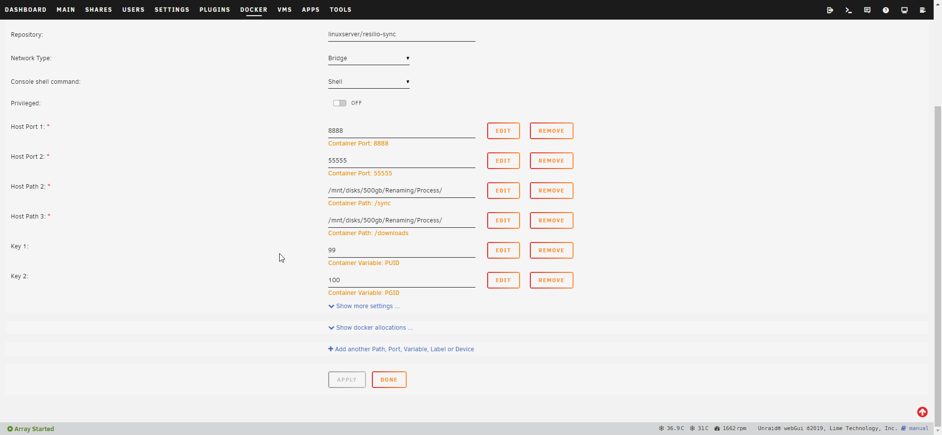

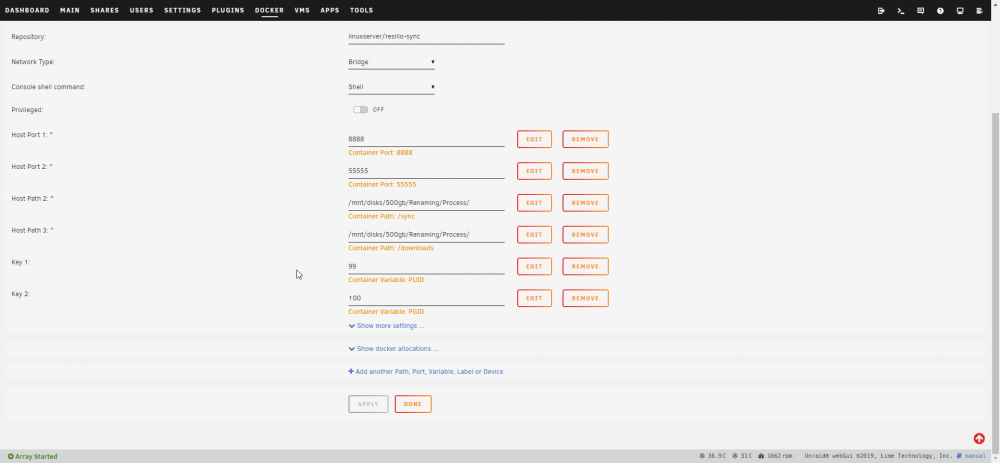

The issue I am facing is that I use Resilio Sync to bring (HardLinked) files across from a dedicated server onto a local UD Share. I then use a Linux VM with Filebot installed to rename the files, and push them to different shares. I am now getting permission denied when trying to run FileBot.
The docker access mode is set to RW/Slave to access (/mnt/disks/500gb/Renaming/Process/)
