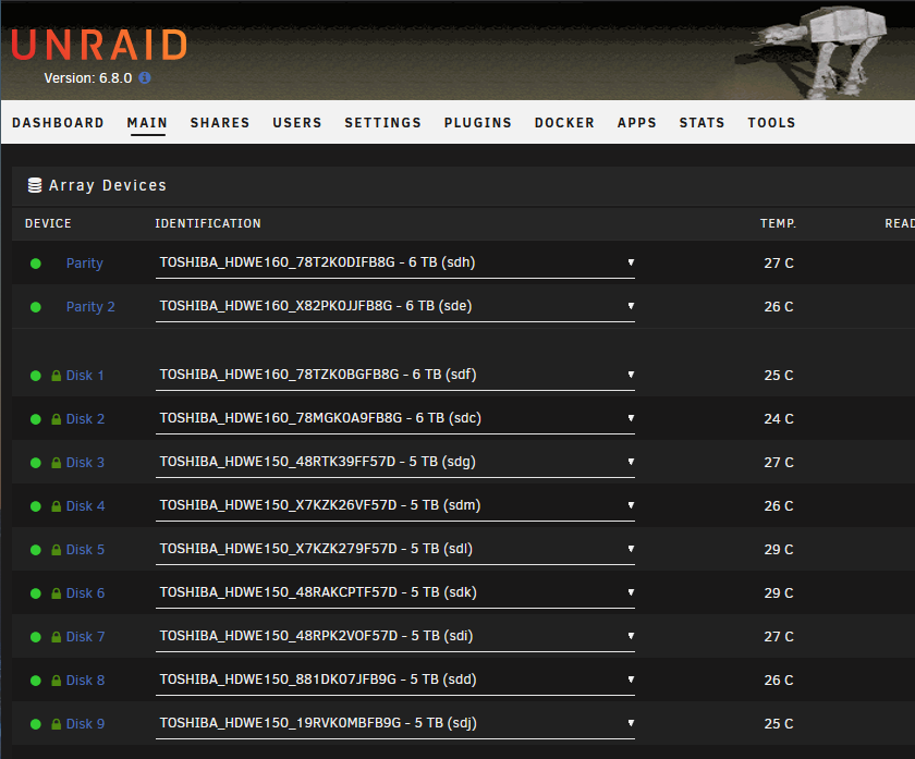

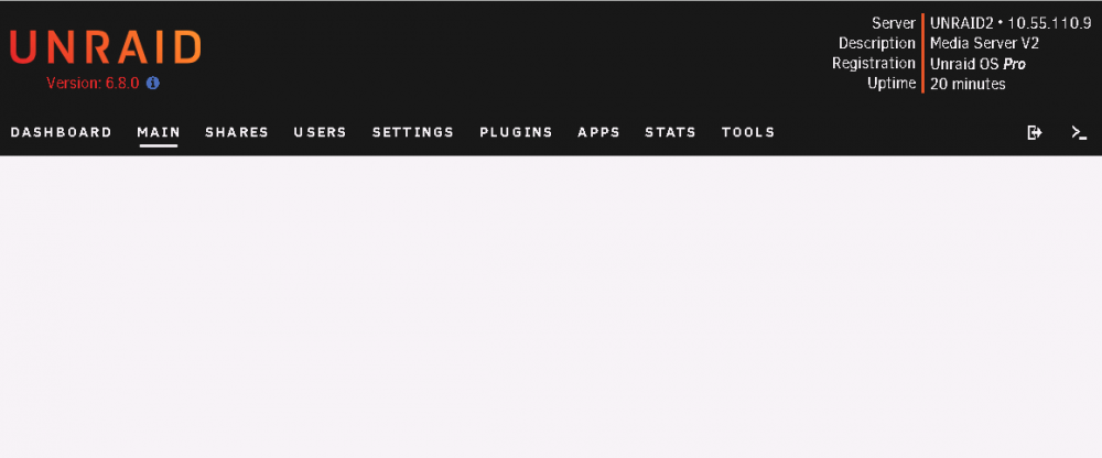

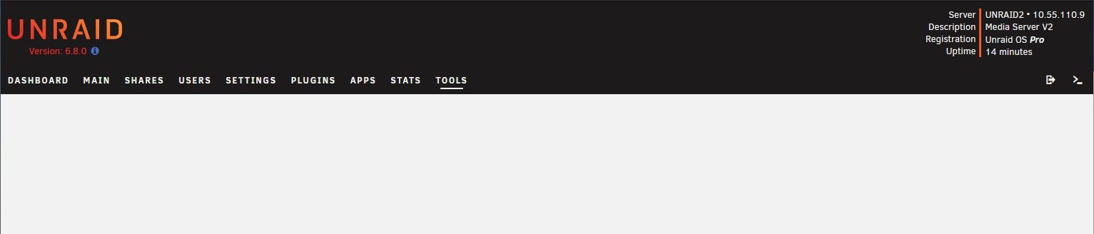

I also have this odd web interface issue where after a bit (usually after attempting to start the array), I lose my custom banner (thanks spaceinvader!) and it reverts back to default. Sometime, I even lose everything underneath the top tool bar which forces me to go the terminal for logs & shutdowns.

Before & After Web GUI woes

I installed Chrome for the first time on another pc on the network. Rebooted the unraid server, I logged in and was able to start the array. It auto started a parity check, a few moments later I "lost" the web interface.
Since I can't get to tools | diagnostics, I've attached the latest syslog via a text file.
Web interface goes back to this below.

I prepped another flash drive with a fresh install and copied the old config folder over top of it. Everything was going the best it has over the past few days. Started the array in maintenance mode with no issues. As soon as I pressed the stop button for the array, the web gui "gave out" on me again. I rebooted the server and tried again, this time I could start/stop the array in maintenance mode but as soon as I tried starting the array normally, the web gui "gave out" on me again.
