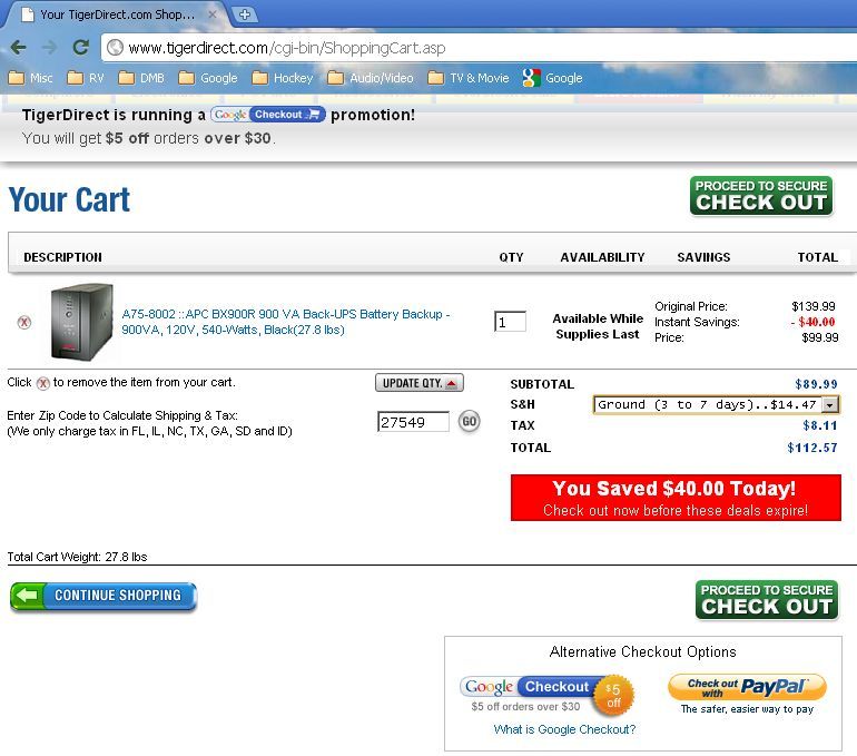

APC BX900R 900VA Back-UPS $79.99@TigerDirect {EXPIRED}
I tried this but had no luck.
It kept telling me:
"Coupon Code could not be verified, please try again."
And I saw no option for google checkout.
My bad.  The coupon deal expired. :-[  Funny it worked this morning.
Google Checkout shows up on my browser.
If you don't live in FL, IL, NC, TX, GA, SD, or ID...no tax.
