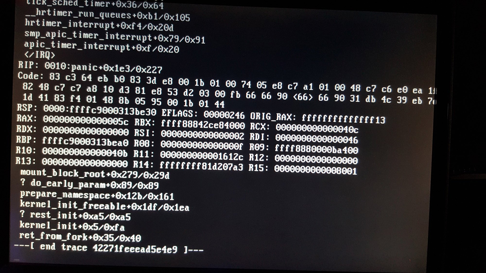

Jumping ahead 3 days later, I decided to boot the server up to find that the USB drive is haning at bzimage and bzroot. Sometimes it passes the bzimage to bzroot, sometimes it doesn't. It is leading me to think that the Sony USB drive Im using is failing or has failed.

I can read and extract all the files with no issues on the USB drive that I thought might be failing. Can I just replace the bzroot file on the USB in question?
I will also attach an image of what it stated after being on for 6 hours. It looks like it goes further if you allow it time.
If you are going to replace any of the bz* files I would suggest replacing ALL of them just in case any of them are corrupt or incomplete.
Following the advice,
I copied files off the USB drive then did a low level format on the drive to be sure there wasn't an issue with it. I then reinstalled unRAID using their image creator, Unraid.USB.Creator.Win32-1.6. After the image was finished I replaced the config folder . Everything booted up and I am back running on the server that was having issues. I would like to know what caused it but at least it was an easy fix.
