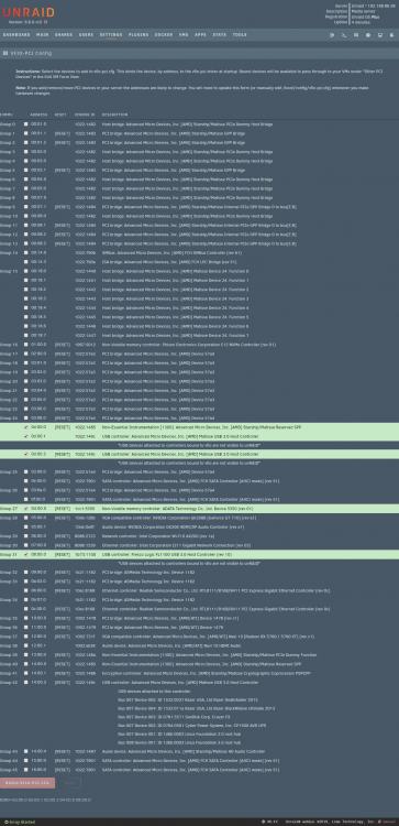

You can not pass through that usb controller on x570. That and onboard audio will lock up unraid without fail. You can pass through the other two usb controllers together, assuming your unraid usb isn't plugged into one of them. See my screenshot, on my system there are 4 devices in group 24. Pass all three devices I have checked together.
If you use my VFIO-PCI Config plugin you can see which usb controller your unraid usb is connected to. In my case it's the Cruzer Fit in 14.00.3. Not that the ".3" here is a bit of a red flag. Even though it is in its own IOMMU group, it is linked to the other 14.00.x devices (10.00.x in your case), which includes the problematic onboard audio (that should be 10.00.4 in your case). It is an agesa bug at the very least. I've seen reports of getting onboard audio working with a kernel patch, I haven't investigated yet, it might also fix the usb issue. Either way, it is best case scenario to use your 10.00.3 for unraid usb and pass the others.

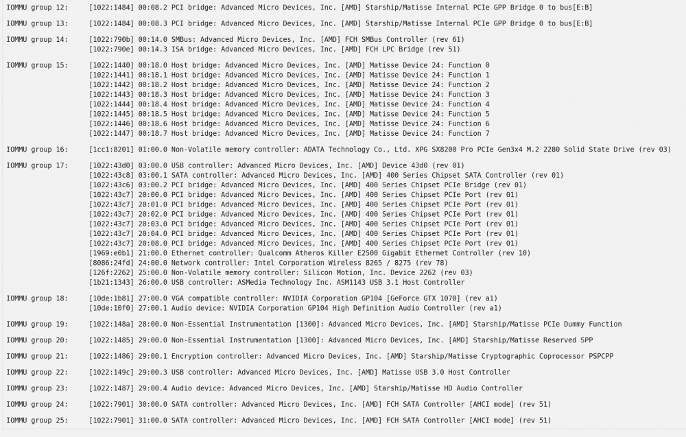

I did my best to map out which usb ports go to which motherboard controller. USB devices connected to the controller I was trying to pass through no longer show up in System Devices, but the Unraid USB stick does. Yes, the USB controller can be reset. It looks like Skitals might have the answer for me on this one.
I dumped the bios myself and removed the header as shown in SpacerInvaderOne's video. Being a fresh vm, I haven't been able to get in far enough to actually install Windows 10 so no RDP.
That makes a lot of sense. I will try that out and report back.

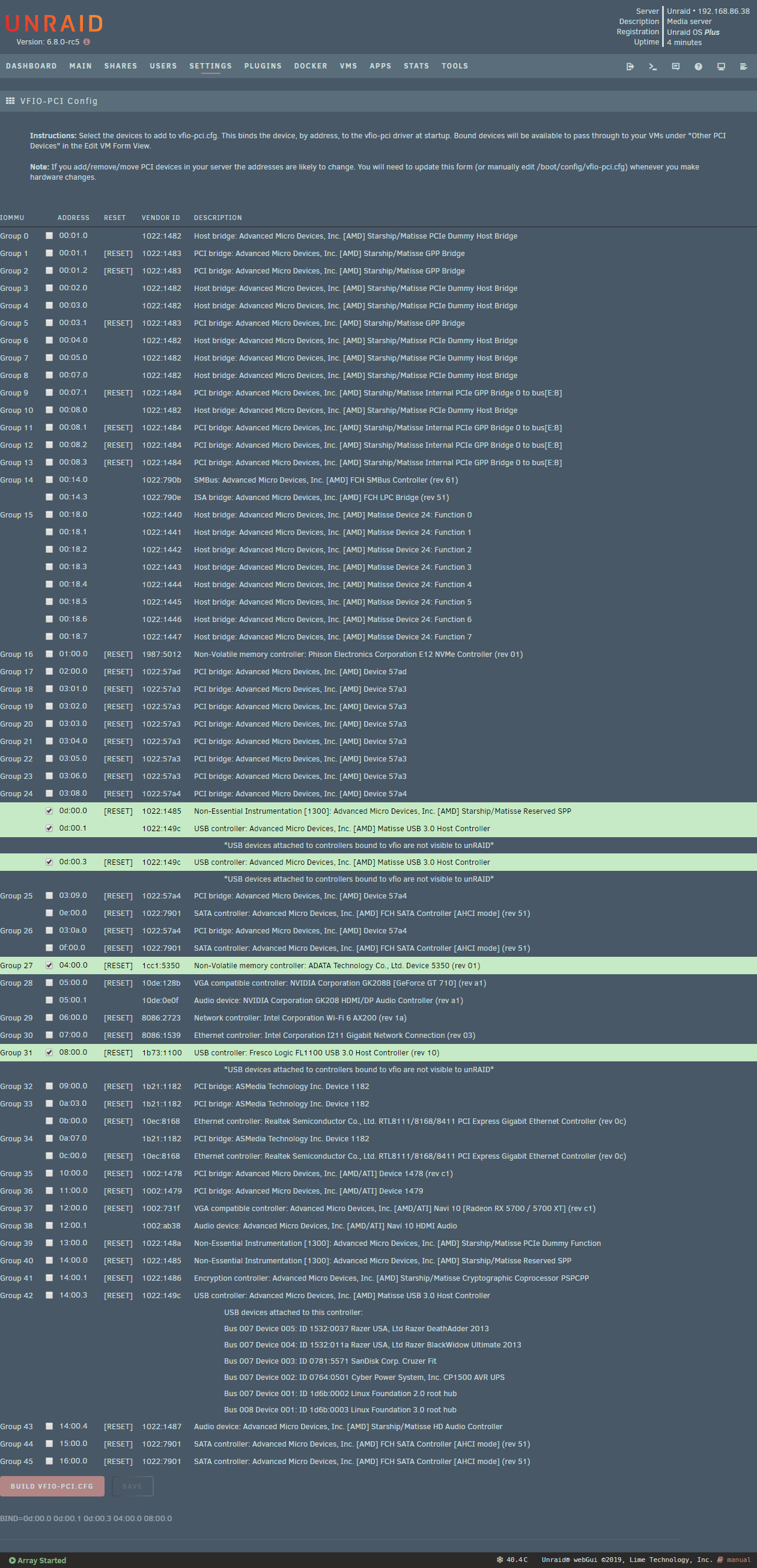

Also note that my 0d:00.1 does not have reset functionality. 0d:00.0 "non-essential instrumentation" controls reset for that controller, which is why it's passed together.
Success! The vm now starts and Unraid doesn't lock up. I am still having the no video problem. @testdasi I assume what I need to do is to use vnc to setup the vm and then try to add the graphics card afterwards so that then I could RDP into it?
Mine is the same (except that it's 0a:00.0 and oa:00.1).
What about 03:08.0 [RESET] 1022:57a4 PCI bridge: Advanced Micro Devices, Inc. [AMD] Device 57a4 since that is in the same iommu group? I think what I typically read is that everything in a group needs to be passed through? So far it seems to be working without that passed through.

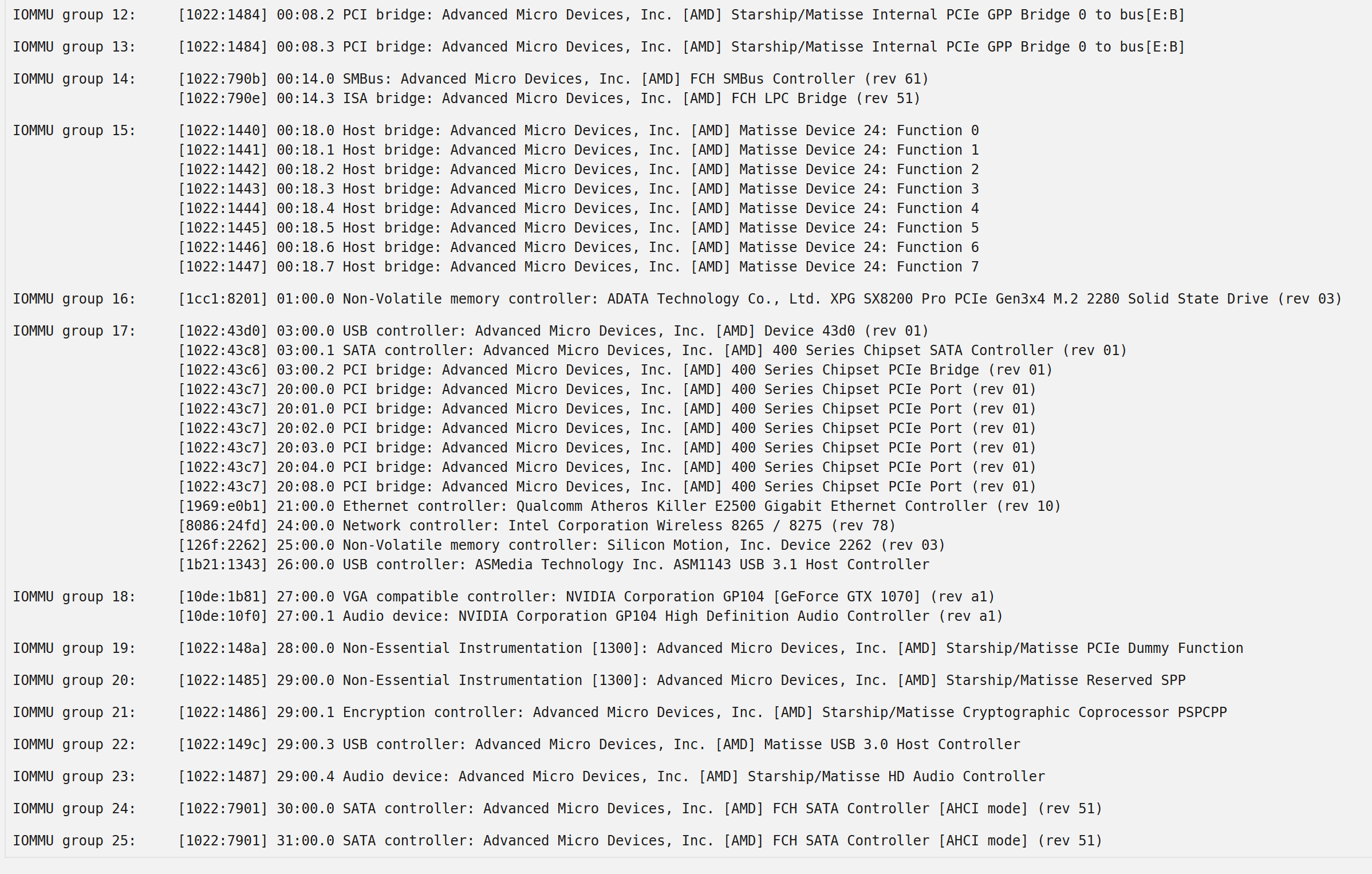

The numbers in the address stand for Bus:Device.Function. You want to pass all functions of a device. Typically saying passing the whole IOMMU group means the same thing... but in this case there is weirdness with the groupings. It's the same reason you want to pass through your gpu audio along with the graphics card, even if they are in different groups (xx:xx.0 and xx:xx.1).
Thanks for this. It's starting to make sense. In all my searching I would keep finding these things that people say to do, but usually not with any explanations as to why.

I wanted to mention, this issue has just recently been affecting me.  I am on an MSI x470 Gaming M7 AC motherboard.  The issue occurred when I switched from the 2700x CPU to the 3900x CPU (I wanted more cores!!).  I swapped the CPUs and all the VFIO Bus:Device.Function numbers changed (that's probably expected).  However, the `USB controller: Advanced Micro Devices, Inc. [AMD] Matisse USB 3.0 Host Controller` (IOMMU group 22 in the pic below) I had passed-through with the 2700x no longer works in pass-thru, even after adjusting for the vfio numbers.  Using it now locks up the system no matter what combo of "Non-essential" components I tag with vfio and pass with it.  @Skitals described this problem with all x570 boards... Looks like it's the same for x470 boards with a 3000 series CPU.  Why the heck is this a problem in the 3000 series, BTW??
I am going down the path of passing through the other USB controllers, as stated above.  Unfortunately, on this board one of the controllers is the front USB, which are not very accessible to me.  The other contains 3 regular USB ports and 1 USB-C port on the back to use, but that is contained in a very large IOMMU group that includes things like the Ethernet controller (IOMMU group 17), so I have my doubts about isolating that back USB panel.
Will provide an update when I get this going... Worst case I buy a separate, PCI USB controller and go that route.
Edited by mattz
added IOMMU groups
Wanted to follow-up.  The cause was totally that FLR issue posted above.  Luckily, someone on this forum had already compiled a kernel with a temporary fix, and I used that.  Note that I tried Unraid 6.9.0-beta1 and it did not yet have the FLR fix in the Linux kernel.  Find that custom kernel for Unraid 6.8.3 here:
