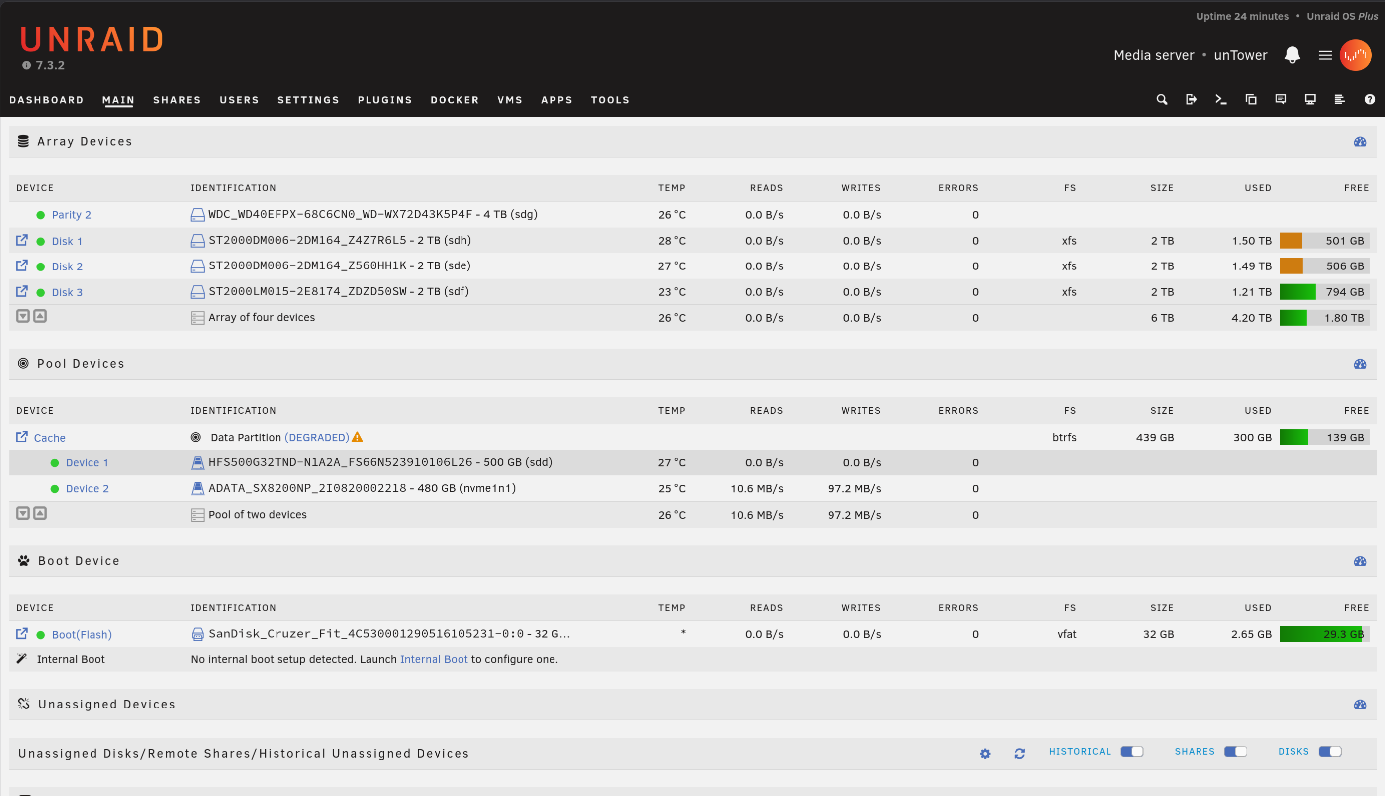

  2. Thanks, @JorgeB. It's running with what looks like all my original data! This is a huge relief. I restarted the server in Safe Mode before I ran that check. The checkbox to "rebuild from parity" was available, but I ignored that and started the array in maintenance mode. I think at that point it was already OK since it wasn't asking me to format the drive. I ran the check, via the WebGUI and it didn't have any suggestions. Started the array in regular mode and it worked! Thank you.
  3. Background in my previous post: I had a failed drive and purchased a new, bigger one and ran a parity swap and rebuild. Everything was going according to instructions until I open up to see how the Data-Rebuild went and see the message (screen shot attached): "Data-Rebuilding finished (21 errors) Canceled". The [previously parity] disk drive that was being rebuilt is still listed as "Unmountable: Unsupported or no file system" despite xfs being listed as the FS (after the rebuild). A couple questions: Did I lose the ability to rebuild that drive from the parity+other data drives (and lose a large portion of my data )? How do I get that drive working in my array? If I lost the data, is it just a matter of formatting (the option is below on Main)? Attached latest diagnostics and a couple screen shots. Edit: I did run a quick SMART check on that 0SW disk after the canceled rebuild, it passed, attached. untower-diagnostics-20231024-0619.zip untower-smart-20231024-0611.zip untower-smart-20231024-0611.zip
  4. Sorry, sorry, sorry. Clearly spelled out as a "3 drive parity shuffle" in the FAQ: https://docs.unraid.net/legacy/FAQ/parity-swap-procedure/
  5. I think I painted myself into a corner. Unraid 6.12.2. Short question: Can I replace a failed data disk in a single parity with a disk bigger than the parity disk? e.g. rebuild the array using only 2 TB of a 4 TB drive? (I think the answer is the parity disk ALWAYS needs to be the biggest). Background: I have a 6 TB array with a single parity; i.e. 3 x 2 TB data disks + 1 x 2 TB parity disk. I had 1 x data disk die on me. I purchased a 4 TB disk because... The WD Reds are nearly the same price for a 2 TB as a 4 TB. However, the GUI is prohibiting me from hitting "start" after I removed the failed 2 TB drive and replace it with the 4 TB because If this is a new array, move the largest disk into the parity slot. If you are adding a new disk or replacing a disabled disk, try Parity-Swap. How can I get up and running at this point? Is this the best path to go down: Copy the current 2 TB parity disk onto the new 4 TB drive (how do I do this??). THEN use the 2 TB parity disk as a data disk, keeping the 4TB disk as the new Parity. Rebuild from here. (now with a 4 TB parity in case of future upgrade)

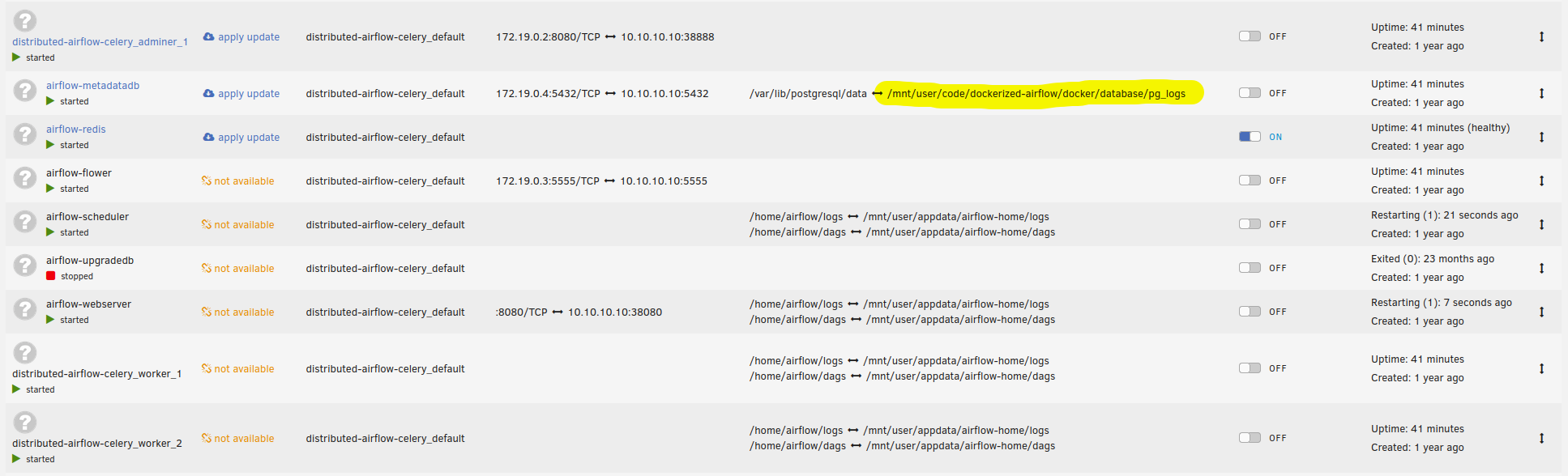

  6. Bear with me - Forgive my ignorance and forgetful brain: About a year ago I set up a Docker Airflow deployment using docker-compose to automatically restart on server reboot. I did this with a docker-compose.yml file (don't remember from where I got the code) and not an App or Plugin. It has been working and bulletproof. Now I no longer need it, but I cannot figure out where I set it up to restart on every reboot! How can I stop Airflow from launching on reboot? Where would this normally be scheduled through? Any log entries I should be looking for to discover this? A few things I've tried: I had a user.scripts plugin entry to start (pip install) docker-compose on every reboot. I disabled that, but on restart the airflow containers are still launching (HOW??) I renamed the dockerized-airflow folder (/mnt/user/code/dockerized-airflow) that contained the docker-compose.yml, but it is still launching and creating the folder for the postgresql db! The code must be somewhere else, but I can't, for the life of me, figure out where. appdata/airflow-home only contains logs and dags, but I have deleted it to no avail. Attached screenshot of the docker containers and mounted volumes. Thank you!
