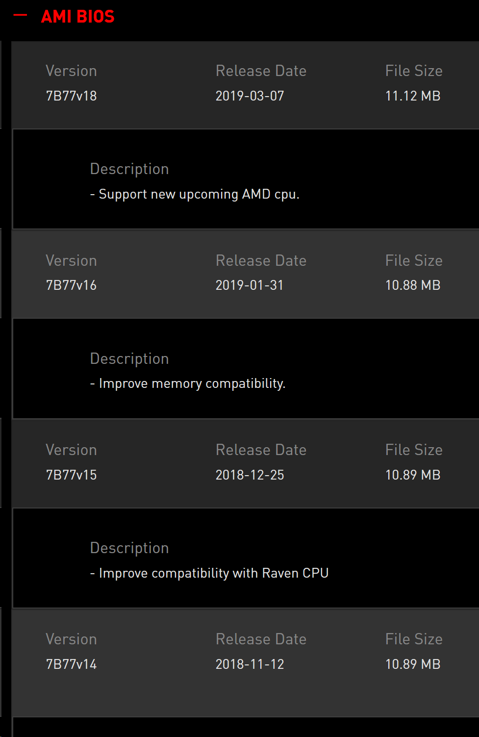

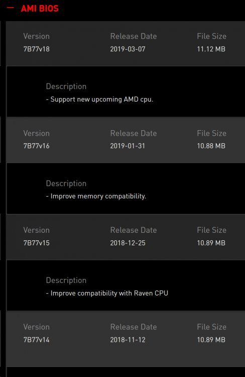

[6.7.2] Win10 VM graphics pass-through broke with latest AMD BIOS
Have a thread going with 13 reports of AMD motherboards that, after upgrade to the latest BIOS, get the following error for Windows 10 VMs with GPU pass-through: vfio: Unable to power on device, stuck in D3 It affects the x300, X400, and the new X570 series mobos. This has been an issue since March 2019 when AMD motherboard manufacturers began preparing for the AMD 3000 CPUs. In the thread, I noted during some early research that the same issue plagued the AMD TheadRipper on x399 motherboards back in 2018(??), and I think the final solution came in the form of a Linux Kernel upgrade. This is my first report. Let me know if I need to change anything, or if it's not applicable here. Thank you!
vfio: Unable to power on device, stuck in D3 (GPU passthrough issue)
@shuruga2 - Sorry about the delayed response. The only success I had with this was to downgrade the BIOS back to an earlier edition, and that works like a charm. You should be able to do this with some *unsupported* software. Check the post I started here--other folks have helped me with my MSI bios downgrade, but I think someone mentioned Asus (which is your Prime x370, right?):
