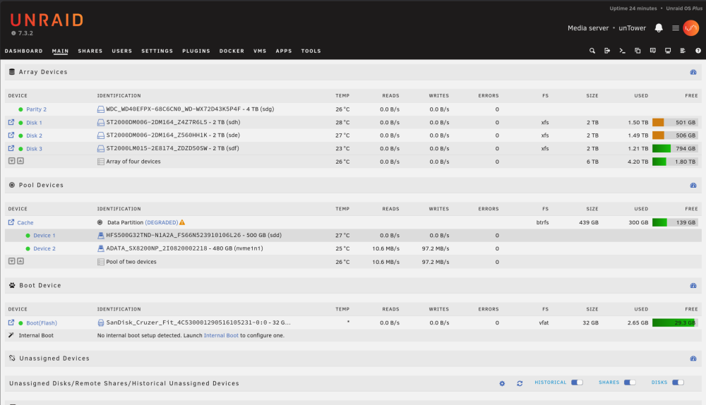

Cache Degraded - 1 drive not working?
I just had this error pop up today, Device 1 (sdd) on Cache pool (Edit: Raid0 it's RAID1, copy, I mistyped that) is not working. It was initially throwing Errors with every write, so I shut down the server and changed the SATA cable. Now I restarted and it has no reads/writes.
Uploaded diagnostics. Is that sdd drive (HFS500) toast? What else can I try?

The first device (the HFS500) failed. SMART reports it as failing, and it also lost its partition, so it's no longer part of the pool. The pool is running degraded using only the ADATA NVMe. All data is still there, because with raid1 the NVMe has a full copy.
Important: the ADATA SMART also shows it's failing. It's worn out (140% of its rated life used, critical warning set). Before anything else, back up anything important from the pool, for example to the array.
