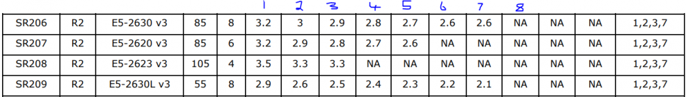

Boost behavior of the CPU's you're looking at is below, seems really quite low especially on the E5-2630L so I was suprised at the passmark figures you quoted.
