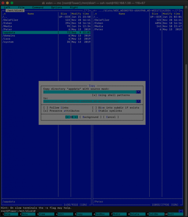

The MC image is to show my method of copying
