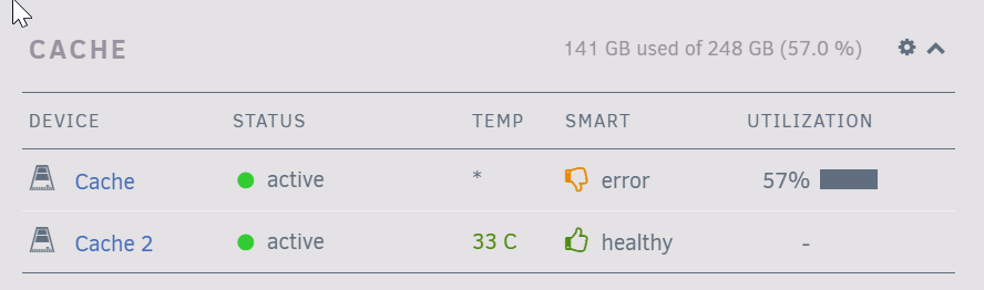

I added a second SSD to my Unraid 6.8.1 server on Monday. I now have a 128GB SSD and a 120GB SSD in a btrfs cache pool.
Seemed to go absolutely fine, balance happened leaving a total available space showing on the cache of 248GB with 141GB used.
NOTE: I have an issue with the UDMA CRC error count on 'Cache' - it was not presenting any issues prior to the move to a pool. I have changed SATA cables since the error first presented itself and the count is stable.

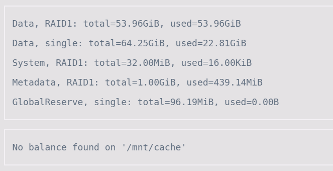

Balance status shows this:
which based on searching, seem to be correct.

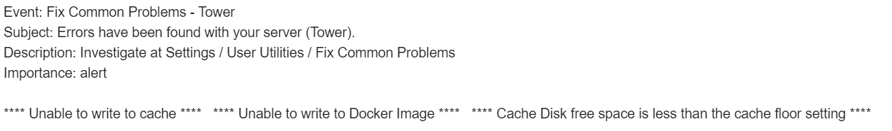

However... on boot up my server is not allowing docker to run. Fix common problems is throwing the following errors:

Cache has dual data profiles, that suggests one of the devices dropped offline at some point, can you get the diags, using the GUI or by typing diagnostics on the console?
