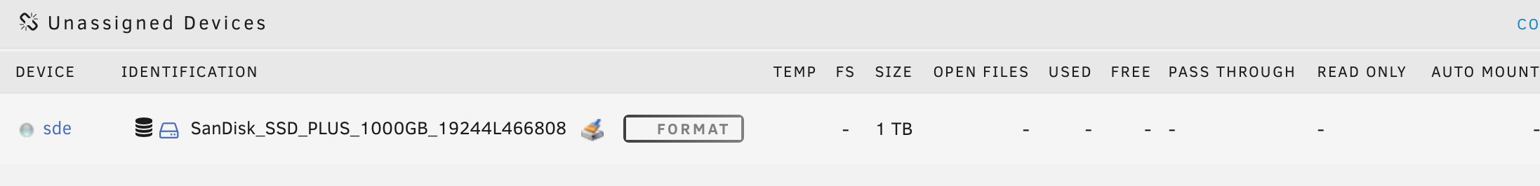

It appears that UD is unable to mount it...
Device doesn't have a partition, it was wiped (or failed).
