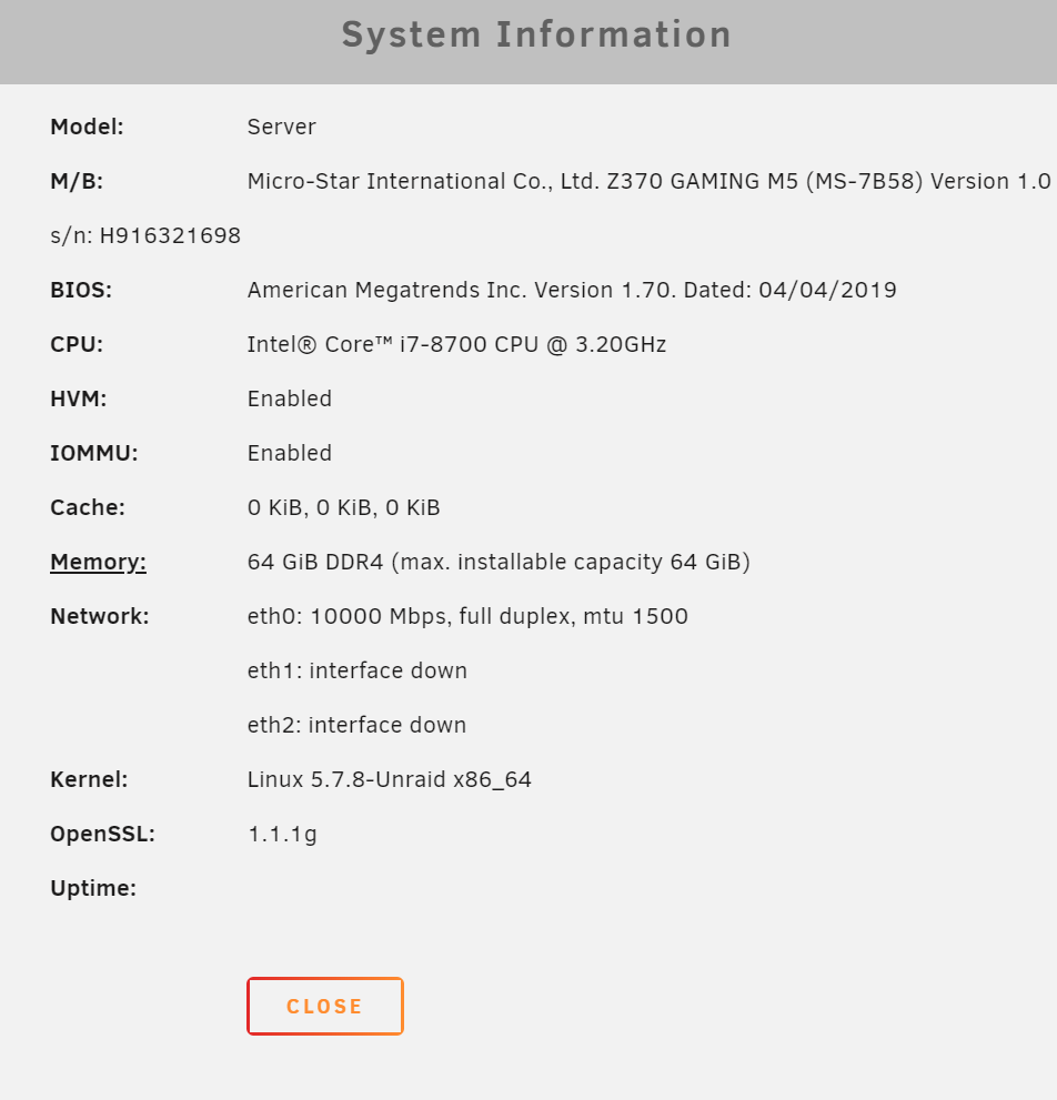

August 7, 20206 yr may also take a look here if iommu is enabled and as mentioned above, how does your iommu look like before ACS, the GPU most likely should be fine without it. Edited August 7, 20206 yr by alturismo
