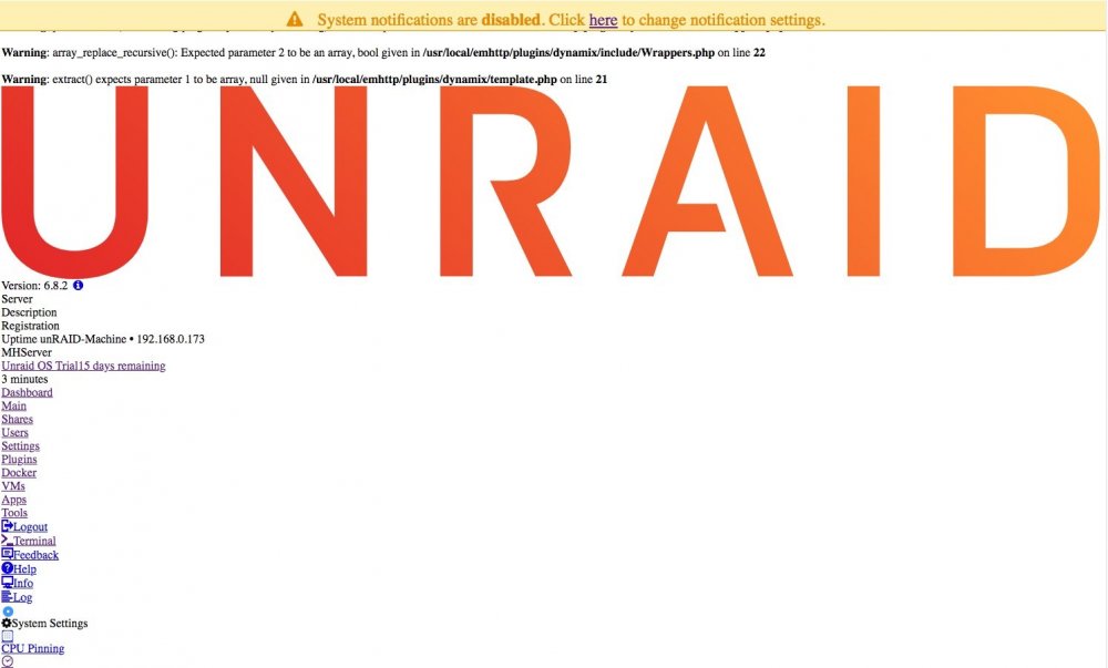

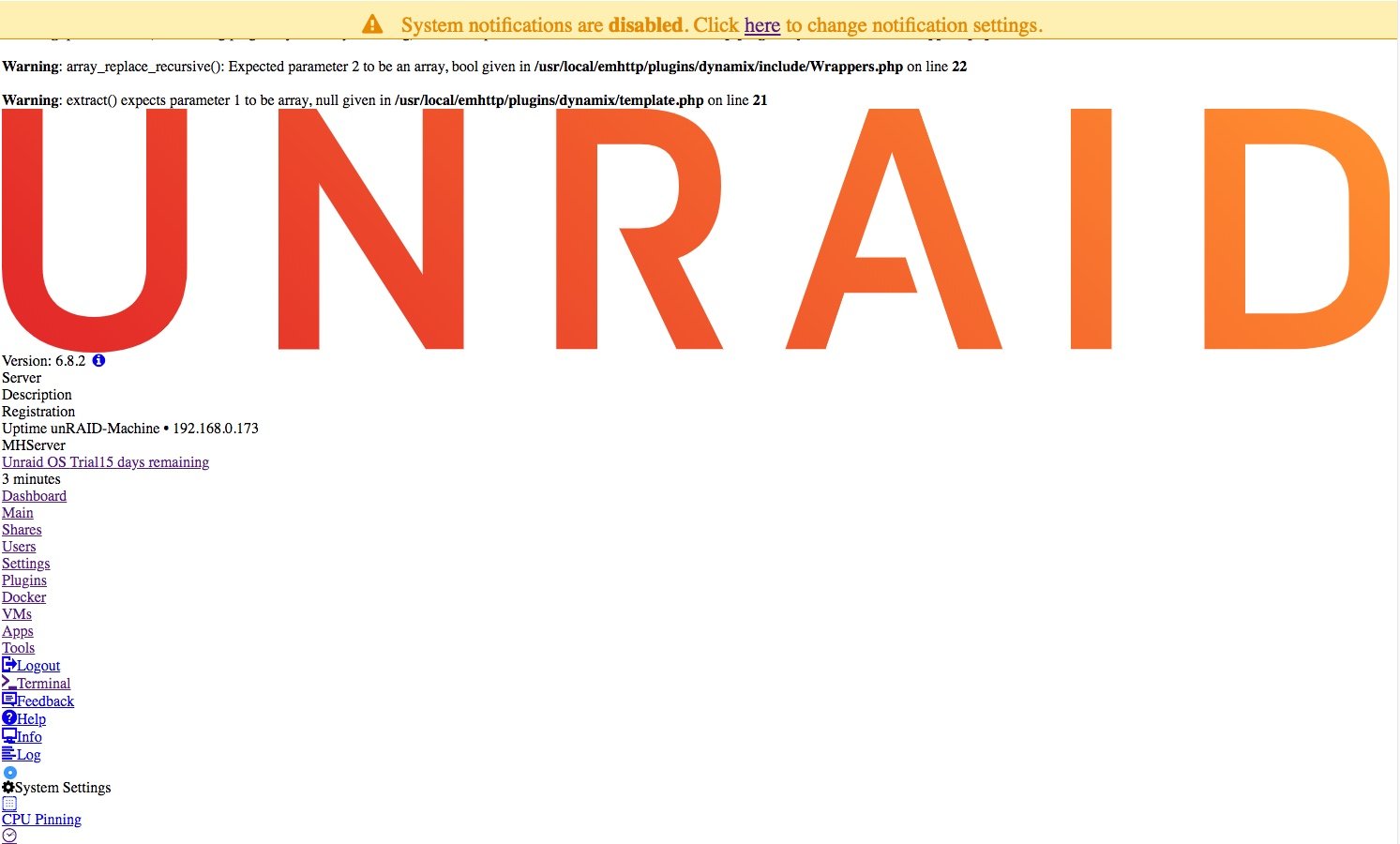

I have just installed the Binhex Prelear docker and right aftre the install my GUI looks like this (see attached snapshot) when I access it from the browser.
I have unstiall the docker, rebooted several times but the UI still looks like innthe snapshot. Is there any way to repair this problem or do I need to reinstall unraid on my usb drive?

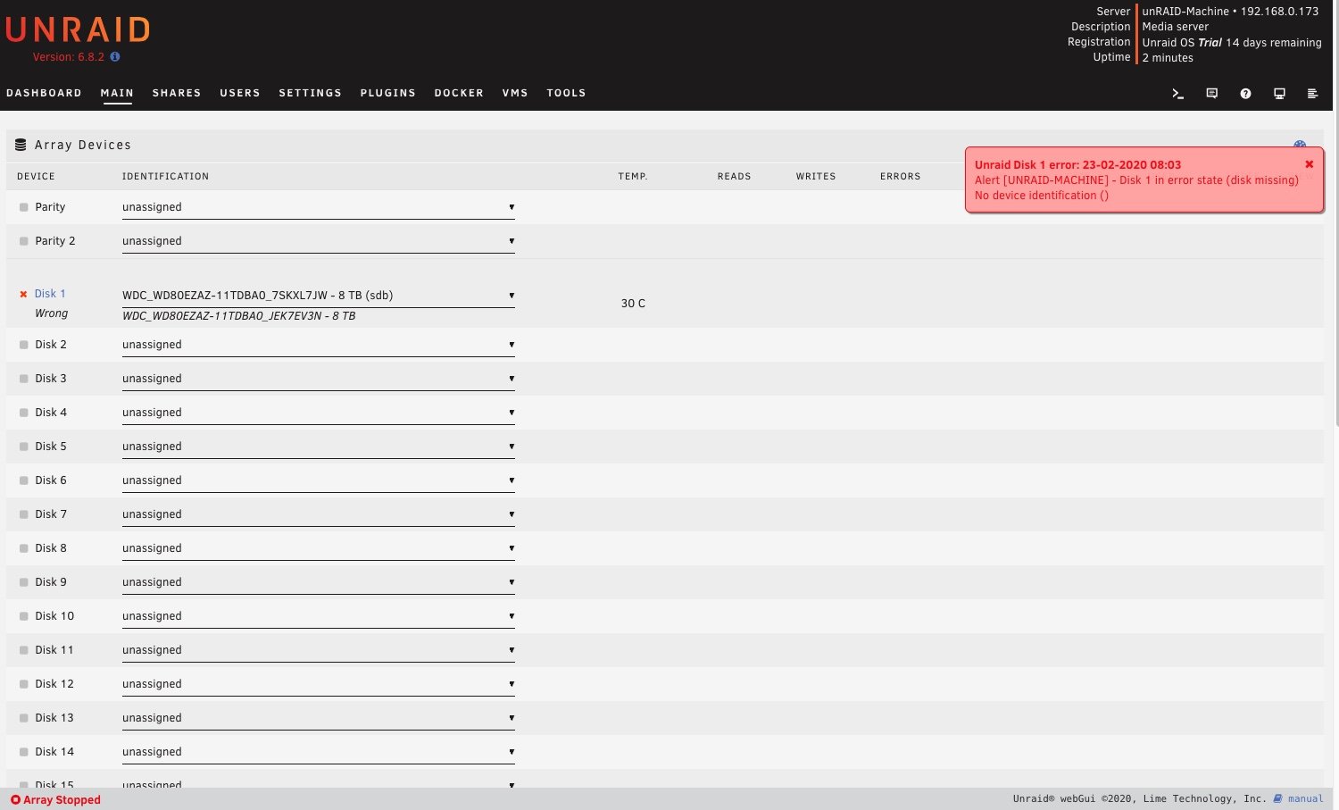

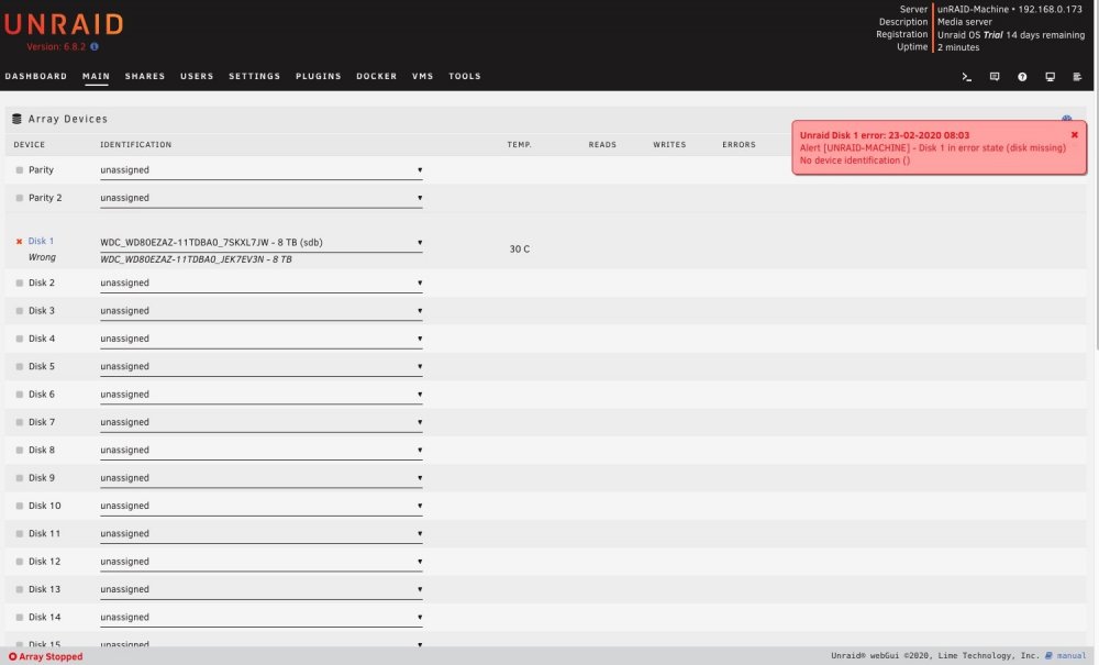

Th bad GUI interface error has gone away but now i'm not able to mount my drive since i'm getting this error
You had disk one assigned as ...7JW  You've now assigned ...V3N as disk one.  The error is correct and proper
Do you have multiple drives?  Do you know what was assigned where?
Yes, there are 2 drives in the build.
  • drive 1:  7JW ( the correct drive to be mounted as disk 1)
  • drive 2: V3N ( new drive added, that was not mounted previously in the arry nor used)
The issue was finally resolved by selecting 7JW as disk2 in the array. Start the array -> Stop the array -> selecting it as disk 1 ( this time it worked) back again -> Start the array.
