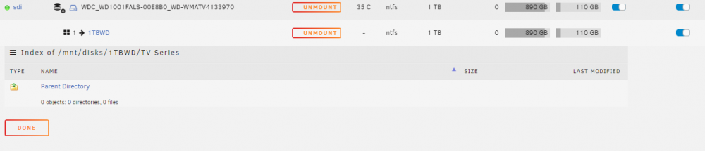

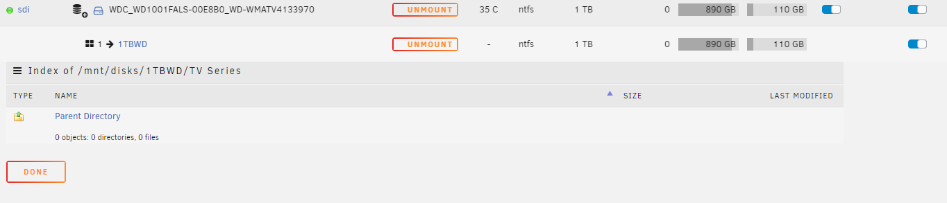

I was transferring files through unassigned devices both are ntfs. I'm moving files from one drive to next one. Not part of the array. When I'm was done and have the drive almost full then I check back the folder where I transferred the files it's suddenly empty. But the free space and used space have remained the same.
I tried unmounting and remounting still the same, folder is still empty. Tried restarting the server still empty.

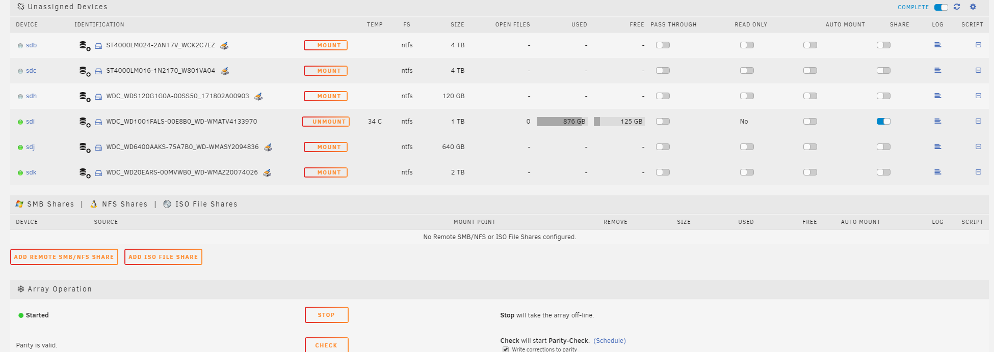

Apologies, yes I have a lot of unassigned drives and usb plugged portable drives which all are NTFS. Yes ofcourse we need more than two drives to files from one drive to another. I just screenshot drive where the files is missing and to show the free and usage to prove the have files not empty. See attached image I have a lot of unassigned drives.
Whenever I tried to access the folder via console to see if the files is still in there. it will "reading directory '.': Input/output error". So I'm guessing an issue on the filesystem. But I don't know how to do chkdsk on linux >.< as it easy as it is to do on windows.
I already fixed the problem, the stupid hassle way. I pulled the drive out of unraid and plugged it to my windows computer, files are there. I ran chkdsk and many errors and it fixed them. All well now, I threw the drive back to  the unraid server and my files are now showing back. All good.
