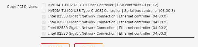

I am evaluating unraid for my needs and created a pfsense vm. I got pfsense installed but it shows no interfaces. Is there something glaring that I am missing?
info:
Version 6.8.2
lspci shows this:
04:00.0 Ethernet controller: Intel Corporation 82580 Gigabit Network Connection (rev 01)
04:00.1 Ethernet controller: Intel Corporation 82580 Gigabit Network Connection (rev 01)
04:00.2 Ethernet controller: Intel Corporation 82580 Gigabit Network Connection (rev 01)
04:00.3 Ethernet controller: Intel Corporation 82580 Gigabit Network Connection (rev 01)

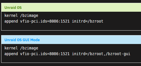

my boot cfg looks like this:
kernel /bzimage
append vfio-pci.ids=8086:150e,10de:1e07,10de:10f7,10de:1ad6,10de:1ad7 initrd=/bzroot
8086:150e is the 4 port Intel NIC (the rest are nvidia 2080ti)

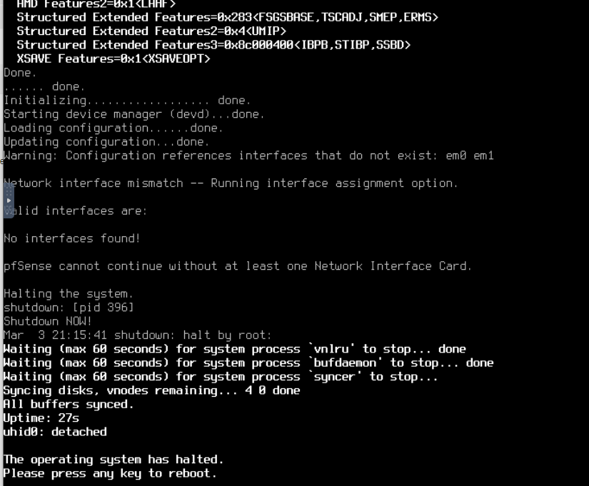

and finally from pfsense:

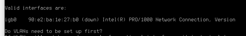

Ill make a note of that, Id rather see if I can get this working first. I added allow_usafe_interrupts:
kernel /bzimage
append vfio-pci.ids=8086:150e,10de:1e07,10de:10f7,10de:1ad6,10de:1ad7 vfio_iommu_type1.allow_unsafe_interrupts=1 initrd=/bzroot
and got 1 of the 4 nics to show up:

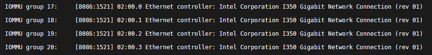

I am having a similar problem trying to passthrough an i350-T4 to OPNsense. I've tried various different Q35 versions (4.2, 2.9, 2.6, etc.) and each time when I boot up the installer it says "no interfaces detected." Checking pciconf -lv confirms that it's not seeing my NIC. Any suggestions? Here is my xml and some other info:

I've read this post on reddit, and the OP seems to have fixed his issue by "Setting the adapter type to vmxnet3 in the XML," but I am not sure where to do that. I'm scratching my head a bit here.
After doing some more research it seems there is a bug with FreeBSD and KVM/libvirt right now that causes issues with Q35. I used i440fx-4.2 and it detected my NICs.
