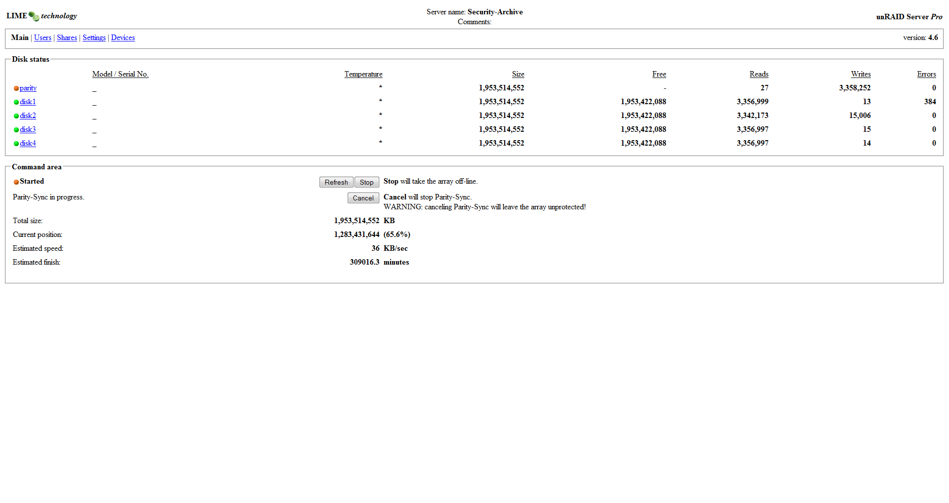

Basically I've built two servers with identical parts ordered at the same time. The first server I built and loaded with 14 2TB drives works just fine. The initial parity sync went just fine and I've transferred 11TB of data to the machine already without any problems.
The second server which I built the same day has given me nothing but grief. The initial parity sync will kickoff just fine but it stalls between 60% and 68% every time. It doesn't matter how many drives, which order they are in, etc. It always fails and the screen looks like the attached screenshot.

These errors are in your syslog.  It might be the one disk
Dec 14 05:15:40 Security-Archive kernel: mptscsih: ioc0: attempting task abort! (sc=f752bcc0)
Dec 14 05:15:40 Security-Archive kernel: sd 1:0:1:0: [sdc] CDB: cdb[0]=0x28: 28 00 98 ff 39 f7 00 04 00 00
Dec 14 05:15:40 Security-Archive kernel: mptbase: ioc0: LogInfo(0x31140000): Originator={PL}, Code={IO Executed}, SubCode(0x0000)
Dec 14 05:15:40 Security-Archive kernel: mptscsih: ioc0: task abort: SUCCESS (sc=f752bcc0
disk = /dev/sdc

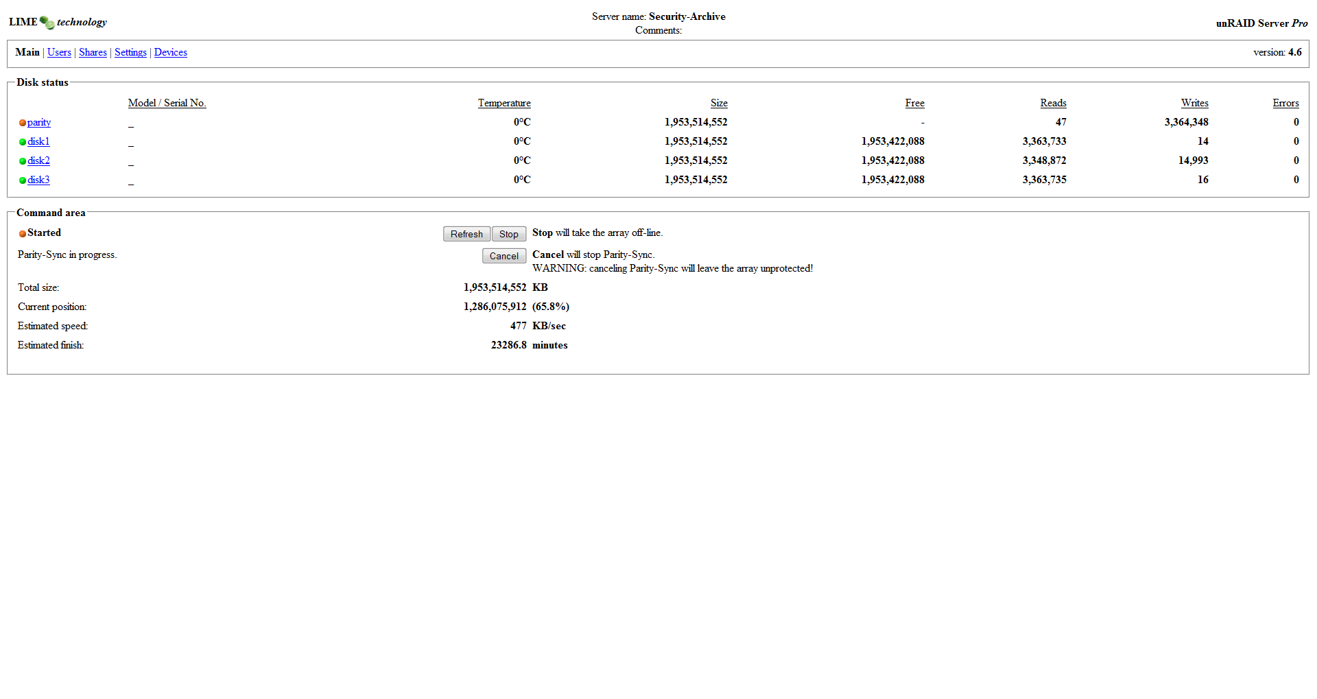

Well, I had high hopes but unfortunately the same thing happened this time as well. Screenshot and syslog attached.
