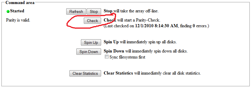

Is there a way to check parity without syncing the new parity if errors
I'd like to do a parity check and not a sync, but I think there's no automated way to do that through the GUI.  Any suggestions?

Do NOT click on the "Check" button as previously instructed, as that will sync and correct parity based on what it is reading from the disks.  If you had a bad disk it would ruin your chances of fixing the disk by reading the "correct" parity.
Joe L.
Click the check button....
This is actually a "Sync" button if any descrepncies are found. It is NOT what you want to do if you suspect a disk is failing.

So the button that says check actually performs a sync???  That's kind of VERY misleading.......
The default parity check is a 'check and correct', so it will correct any parity errors that it finds on the fly, always assuming that the data drive has the good data and the parity drive has the bad data.  If you have a failing parity disk, then this may be what you want unRAID to do.
However, if a data disk is failing and spitting out bad data, a parity check will actually cause the otherwise good data on the parity drive to be overwritten with bad data from the failing disk.  This is why you should always run a 'parity verify' (check but do not correct) from unMenu or from the command line if you suspect a disk may be bad.
I agree that it is misleading, and I and others feel that the default option on the unRAID GUI should be the safer parity verify, with parity check being a 'I'm sure I want to do this' type of sub-option.

I decided to tinker with greasemonkey a bit, (javascript is a PITA!) but I managed to knock out a simple script that will add a big red warning about that button!  And for fun I made it add a link to unMENU on the main nav bar.  Fancy right?  ;D
