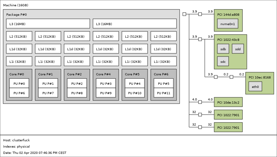

Try to see if your VM would boot without the USB controller. I think it's the USB controller that prevents it from rebooting as it can't be reset.
  • 03:00.0 is USB 3.1 controller, which is typically not pass-through-able.
  • 28:00.3 is USB 3.0 which probably will give your better luck.
Before trying the 28:00.3 though, go to the app store and install VFIO-PCI Config plugin then settings -> VFIO-PCI.CFG and look for the 2 USB controllers. It will tell you which USB device is plugged into which controller. Make sure the USB stick is NOT plugged into the controller to be passed through.
If you picked 03:00.0 because your USB stick is plugged into 28:00.3 then you need to use a different port (preferably USB 2.0 port). To test which port is on which controller, you use a mouse or ANOTHER USB stick and just refresh the VFIO-PCI.CFG page for each port.
(Hint: usually ports in the same "block" in the rear panel are connected to the same controller).
Thank you for your fast reply. 👏
Now I tried a few other things, but sadly still not successful.
1. I created a new libvirt.img at /mnt/cache/system/libvirt/libvirt.img -> Then recreated a Windows 10 VM started successfully, rebooted and failed.
2. I removed the USB controller completely from my syslinux config. Rebooted Unraid, recreated a Windows 10 VM started successfully, rebooted and failed.
So I think the problem is not from the USB Controller?

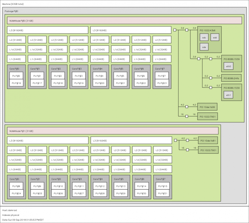

If you boot unraid in GUI mode you should be able to use "lstopo" to generate an overview to see how devices are connected together.
Example output:
Edit:
Adjust the path for your needs so you can find the picture.
lstopo /mnt/user/appdata/topology.png
Edited by bastl
@bastlHere is the image. I guess all the four SATA Ports of my mainboard are connected to the same controller.
The thing that wonders me is that even without USB Controller Pass trough this problem occurs. So I hope it is not connected to the SATA Controller.
@sub6 Your IOMMU groups (31+32) shows another SATA controller. You can see them in the lstopo as well (PCI 1022:7901). Could be that your motherboard already has the controller on board without physical connections, reserved for higher tier boards. Thats what confused me. So, forget about that.
If you have another ssd or an old hdd laying around, I would test the passthrough with another disk and the same xml. Not sure, but in the past users with some intel ssd's had issues as well. Can't remember which model. Maybe it's an specific thing with this Samsung SSD and your SATA controller.
