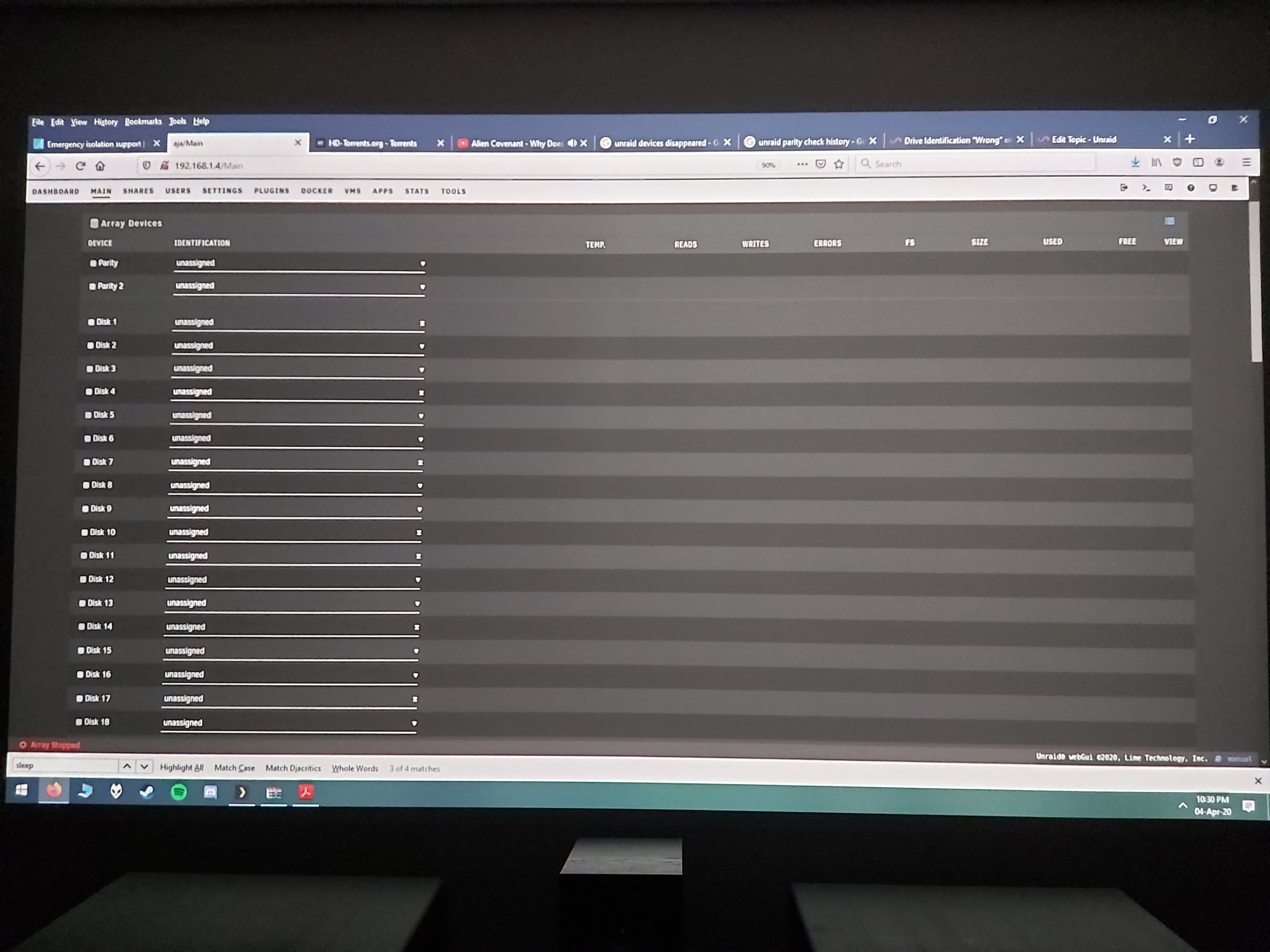

After that I had to restart the server and upon restart the same problem appeared, so I did the "New Config" again with "Retain All" but this time all devices showed up as unassigned? I'm kind of stuck now as I have no idea what the correct device order was/is/should be. What should I do at this point? Is there a log or history somewhere I can look up the correct device order?

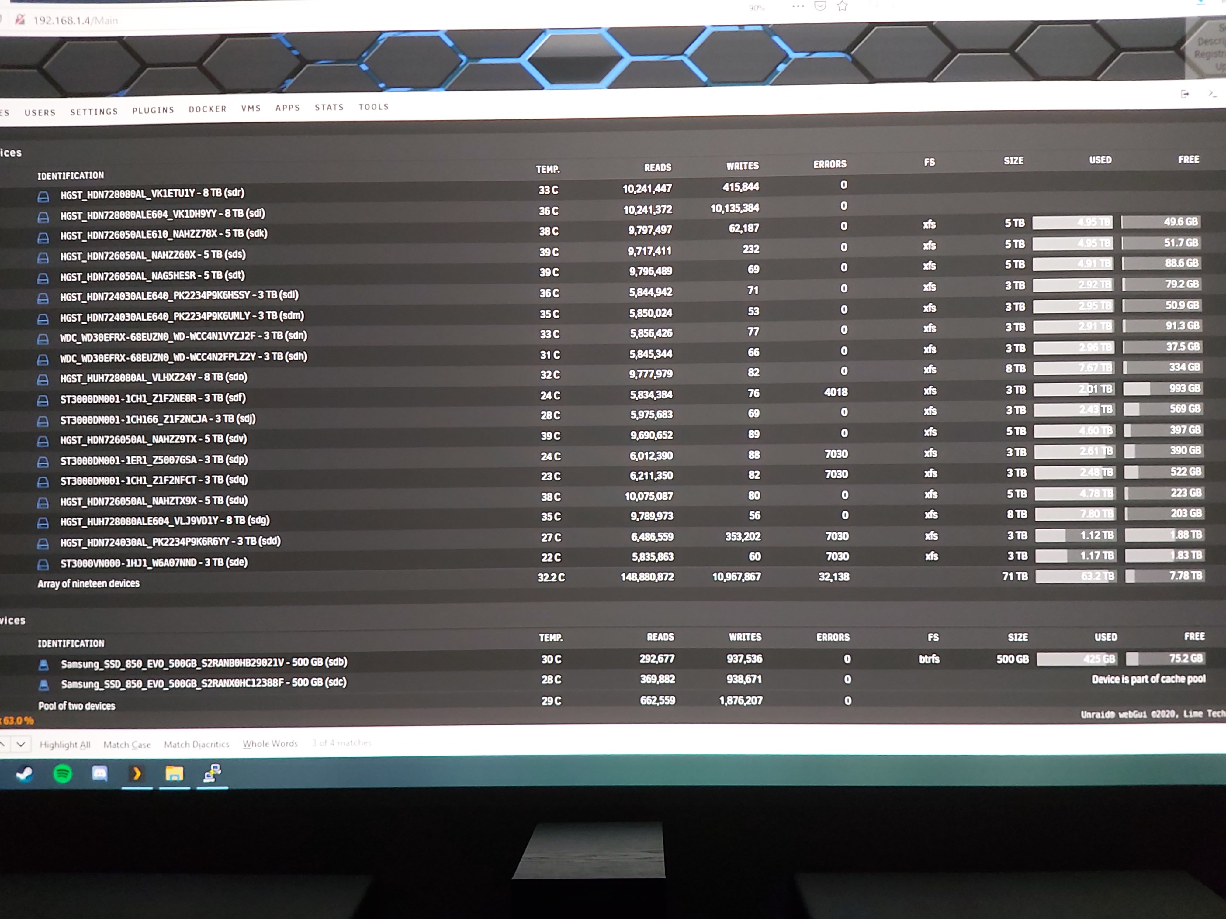

So while running the parity check, a bunch of read errors started to pop up on several devices. Does this mean my drives are toast or should I look for a hw problem at this point? I will let the parity check finish first. Log attached.

Disks look fine, and the errors happened on all five disks at the same time, which virtually rules out a disk problem, check all connections especially anything shared by those disks, like power cable, backplane region, etc, could also be a PSU issue, unlikely to be controller related since they are using two different controllers.
I replaced a power cable and all is back to normal. Thanks a lot guys, really appreciated the help. One last question, is it prudent to run another parity check after this?

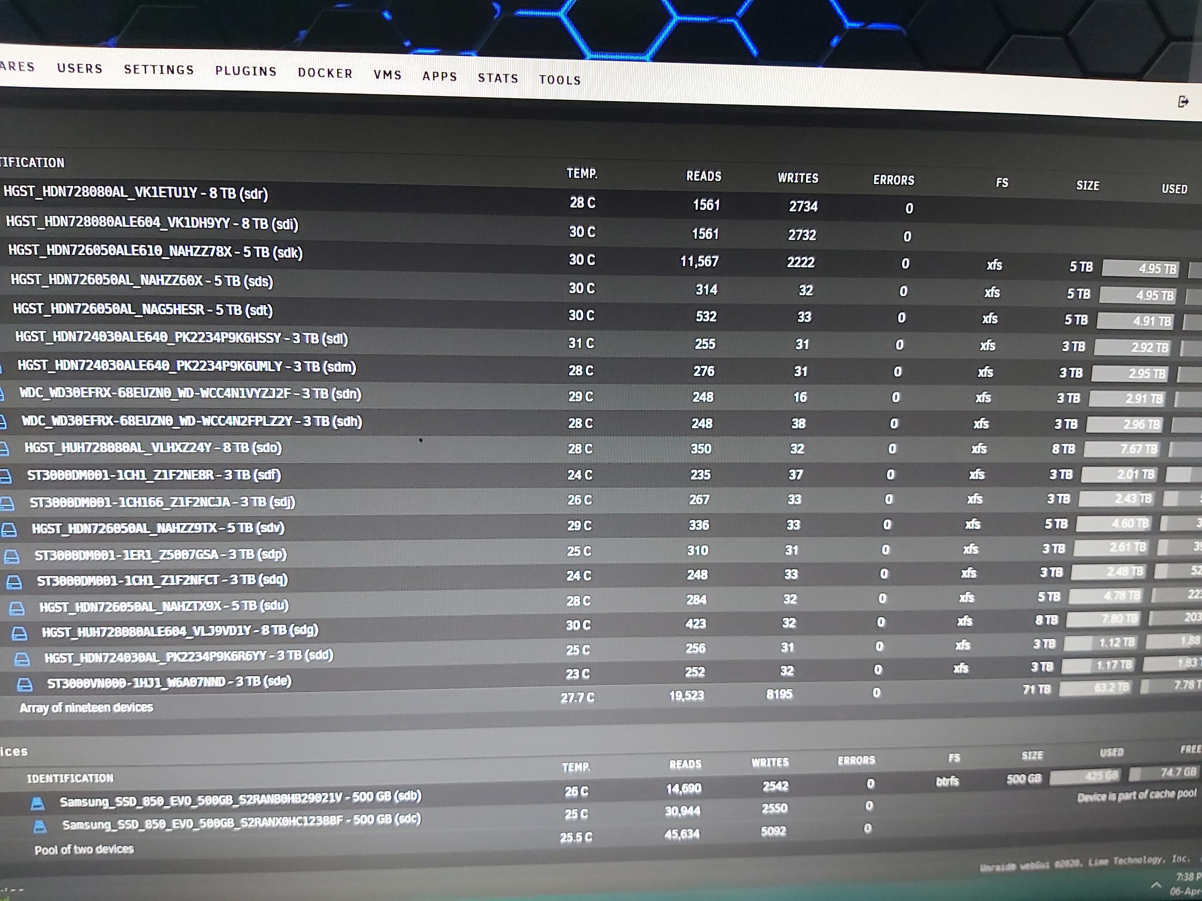

Oh and one last question, I have added a second SSD for the cache drive. It does say it is part of the cache pool but it still only showing 500gb total. It's probably something silly, sorry.20200406_193845.thumb.jpg.855dbef6c2a03d0dbd701d737d543101.jpg
Default profile is RAID1, so usable space will be the same, but it can be changed.
