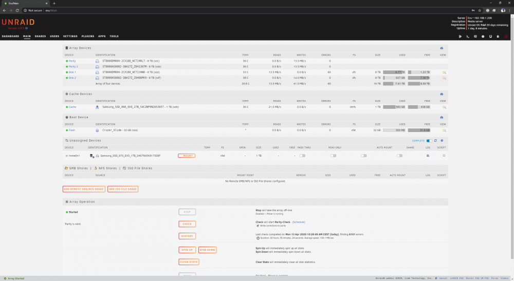

Very slow speeds moving from cache
<TLDR>I'm getting ~20MB/s read/write speeds when Mover is moving from SSD cache to array, what am I doing wrong?</TLDR>
Hi all,
I'm very new to Unraid and the forums, so I apologize in advance for any frustration I will cause with my ignorance. I'm currently evaluating Unraid to see if it is for me, and in the beginning it all looked so promising so I decided to take the plunge and move everything I have in terms of storage into Unraid. I also bought a new 1TB SSD to use as a cache drive, so now my disk setup is:
Parity 1: ST8000DM004 8TB SATA
Parity 2: ST8000AS0002 8TB SATA
Disk 1: ST8000DM004 8TB SATA
Disk 2: ST8000AS0002 8TB SATA
Cache: Samsung SSD 860 QVO 1TB SSD
Unassigned pass through disk: Samsung SSD 970 EVO 1TB NVMe M.2
After I added the cache drive, I started getting constant warnings and errors about the cache being full. I fully admit that I don't really understand how to use the cache, and certainly understood even less in the beginning. I guess I just assumed if I added a cache drive and used the "Fix Common Problems" plugin it would tell me if I was using it in a bad way. Anyway, I got frustrated with all the constant notifications about the cache, so I changed the cache settings on all shares, I don't remember to what exactly, and started Mover manually. It started moving at an extremely slow rate, and then something went wrong. Maybe it was because I changed the cache settings while Mover was running in an attempt to make a difference since it had only moved a few gigabytes after a few hours , but the result was that the system was extremely slow and unresponsive, and Mover stopped working altogether. This went on for hours and nothing changed, so I tried to shut down Unraid without success. In the end I was forced to kill it by holding the power button. After it came online, it started a parity check that took many hours, during which Mover woke up and started moving stuff from the cache. This slowed down the parity check which in the end took ~21 hours (and resulted in 6101 errors), but it got there eventually. Mover still keeps running though, and it's still extremely slow at around 20 Mb/s. I think it's scheduled to start at 03:30 in the morning, so by now (14:15 here in Sweden) it's been running for over 10 hours and it's about half way done.
The system is not doing anything else, the VM and Docker manager are both stopped. The cache settings right now are either "No" or "Prefer" on all shares, because I feel like I want to get rid of the cache drive. It's only causing me frustration, and as I said, I don't understand how it's supposed to work. Is there anyone who can help me figure out what I'm doing wrong? I attached diagnostics and a screenshot showing the Main-tab with read/write speeds.
Worth noting:
1. One of the drives, the ST8000DM004 used as disk 1 has gotten three "reported uncorrect" warnings the past few days. It's a quite new disk, so as long as this value stays at 3 I'm writing it off as one time issues caused by the troubles I've had setting the array up in the beginning.
2. The other array drive, the ST8000AS0002 used as disk 2, has write cache disabled and it ignores my attempts to enable it.
If you've made it this far, thank you for taking your time to read all of it. Sorry for all the faux-pas I've no doubt commited.
/Rickard
eru-diagnostics-20200413-1326.zip
Ultimately, you want appdata, domains, and system shares on cache and staying on cache so your dockers and VMs performance won't be affected by the slower parity writes, and so they won't keep array disks spinning. And you have plenty of capacity on cache for that and caching some user share writes if you want.
None of your shares are prefer. Looks like the only ones that have contents on cache are Yes, and that is good for now. You will make appdata, domains, and system prefer eventually so they will get moved to cache.
Cache has plenty of space now, no telling how you were filling it before since you have changed your settings. Were you trying to cache the initial data load?
Mover is intended for idle time, so if you were trying to write to the array and move at the same time then mover would have been competing with other things for access to the disks. Maybe you were even doing a parity check or something like that that would have slowed things down.

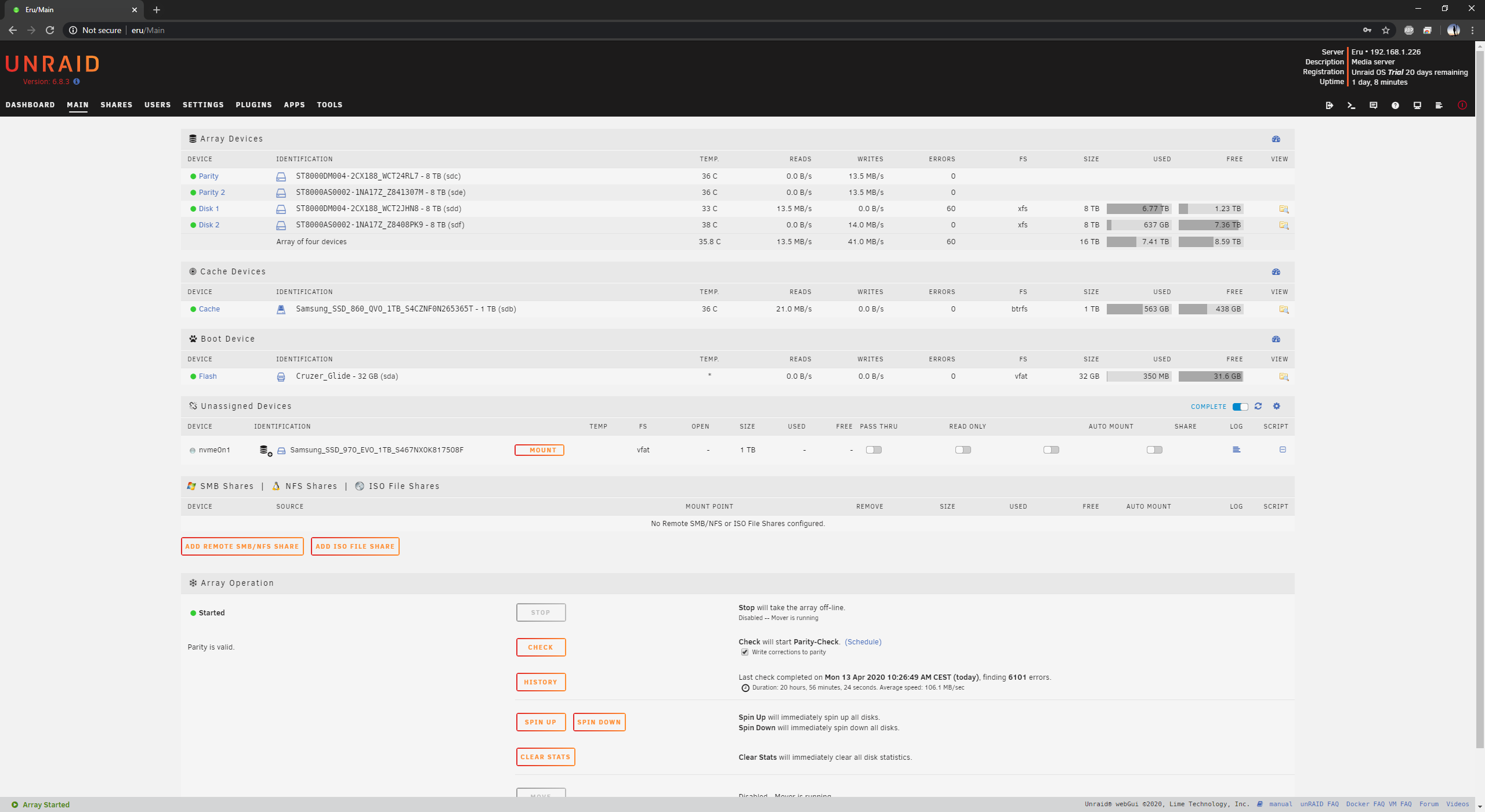

Hi again,
Thanks for an extensive answer! My mover finally finished, and after reseating all cables in both ends I booted the machine and started an extended SMART test. It's been running for over an hour now and completed 10%, so I'll leave it over night again and will probably have to kill it in the morning.
My issue with slow mover speeds is moot, I guess, since it finally finished and I will get rid of the cache or move to something other than Unraid, so the following are only my own reflections on cache drives in Unraid, and can be ignored.
Thanks for explaining how the cache drive is used. I'm not sure I really missed your points, it's just that I don't want to have my appdata any less protected than my other data. I don't have enough connectors on my motherboard to connect another cache drive, and even if I did, I think it's absolutely not worth it. I have two parity disks to make sure I can suffer two disk failures and still have all my data intact. To upgrade to a cache pool, I would have to spend more money, and only get protection from one disk failure. It seems to me that you can't get uninterupted uptime (by not having to shut down VMs/dockers), protection against data loss (by writing to a parity-protected array) and speedy transfers (by using a SSD cache) with Unraid, and I must say I'm really surprised by that. The backup app you mention also requires the docker to be shut down to be backed up.
