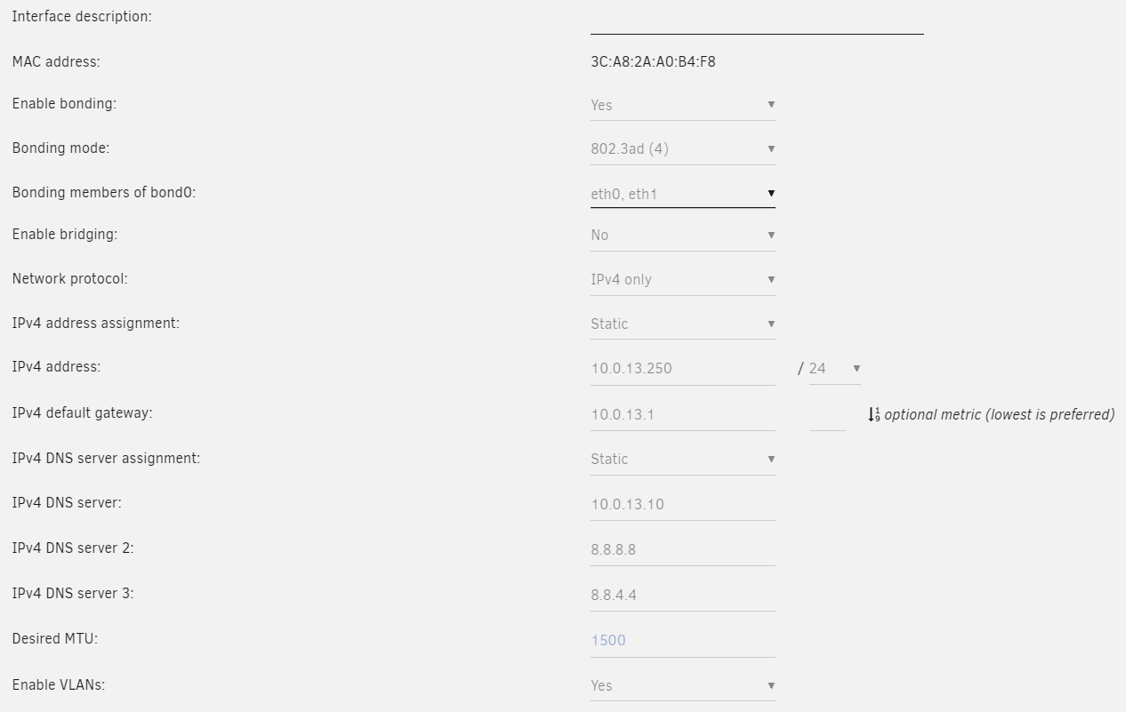

My networking settings:

Can you please share your network settings and maybe the network settings of a VM?
