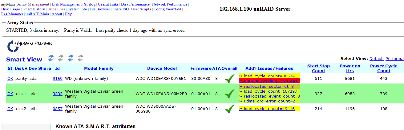

Current Pending Sector = 1
In the Mymenu SMART tab my parity drive; a Western Digital 1.0 TB EARS shows a current pending count of 1 which never goes away.   I have done a parity check I have even re-cleared this disk and it is still there.   How do we get these sectors to re-allocate and clear the error?

Try a parity check. As long as the reallocated sectors is not increasing and pending stays at 1 you don't need to worry about it. It will go away when you write to that sector.
It may not be in an area you can write to.  It could be in its internal pool of spare sectors.
You said you cleared the disk a second time and that process should have re-allocated the sector... but it did not.  A parity "check" would not do anything, since it is simply reading the disk and if it was a sector we could write to to fix it would take a "write" to the sector to get it re-allocated.
Whay you can do, thanks to the wonderful implementation of myMain is click on the line on the display that says "current pending=1"
It will open up a new browser window with a set of fields for that drive.  It will fill in on the bottom of that form a current_pending_ok with a value of 1.
If you then click on "Save" for that disk it will not show that item unless the value changes on a subsequent display of the myMain screen.  You can do that for any of the values it is showing to "hide" them from view unless they change.
One of the "refresh" icons on the top of that page will refresh showing the hidden items.  The other will refresh hiding them as defined.  It allows you to clean up the display and still be alerted if a drive begins acting up with more errors.
a parity check will not do anything unless the disk returns an error to the OS when you attempt to read the sector marked as un-readable.
What you can do is
1. Stop the array
2. Un-assign parity
3. Start the array with parity un-assigned
4. Stop the array once more
5. Re-Assign the parity drive
6. Start the array once more.
This will force a full calculation of parity.  It will write to every parity sector.  For 99.9999999% it will write exactly what is already there.  For the one un-readable sector, it will write what should be there but could not be read.  That should force a re-allocation or re-write if the un-readable sector.
If a different disk should fail during the procedure of rebuilding parity onto itself you can regroup easily since you really do have a full set of parity data (all but one sector... maybe), you just need to take an extra manual step to force it to be trusted.
Joe L.
Yes - this feature allows you to keep your smart view "clean" so that new problems immediately become apparent.  (The "RAW" refresh will always allow you to see everything).
I noticed from the screen shot that the OP is getting some of the load_cycle_count (LCC) warnings.  This is a new feature.  My purpose was to make users aware of the LCC growing before they get to some high value.  There are ways to slow them down, and it is up to each user to decide whether to employ them.
Disk1 at > 167,000 LCCs is worth investigating IMO.  I have several of the 1T EADS and the LCCs are in the hundeds (not hundred thousands  :o ), and mine have more power on hours.
The myMain feature Joe describes will "hide" a value from the the smart view if the actual value is equal or less than the "override" value.  When you click on the item you want to override, it will automatically assign the "..._ok" (override) value to the current smart value.  For example, if you click on "reallocated_sector_ct=3", myMain will set "reallocated_sector_ct_ok" equal to "3" (you just have to hit SAVE on the drive settings page).
This works well with reallocated sectors, which should not normally be increasing and you'd like to know if they go up by even one more.  But for something like LCC, it is pretty useless because LCCs will continue to increase in normal use, and the very next LCC will result in seeing the message again.  So if you override the LCC you should increase the value to the level you'd like to be reminded.  So, for example, if the LCC is 38534 , you might want to set the value to 50000 or 100000.  If you've convinced yourself that LCCs are not worth being reminded about, you could set the value to a very large number and never see it again.
For something like pending sectors, that can go up and down, I'd be careful about setting an override value.  If you get one stuck with a few pending sectors, go ahead and use it.  But otherwise do what you can to clear them.  What you don't want to do is, for example, accept 2 pending sectors, then have those pending sectors get reallocated (putting pending sectors back at 0), and then get another pending sector and not see it.
Perhaps when hiding a value it can be designated as hidden only if exactly the value being hidden.  (leading "=" sign perhaps)
That might handle hiding a current-pending=1 that refuses to go away because we never write to that sector.  It would still alert you if the value changed to a lower count.

The pending sector count of 1 will not hide for that drive.  Makes me think it isn't actually there.  Anyway to reset the MyMenu and have it reload?
Kryspy
Kryspy
It is reading it from a "smartctl" smart report on the drive every time you display the page.... so basically, no.  As I said earlier it is probably a sector you cannot write. (one in its spare pool perhaps)
To hide it, click on the pending-sector.  It will bring up a pop-up screen for that disk.  Click on "Save" for that disk.  Then go back to the myMain screen, it (that line) should be hidden.

That's what I am saying.  I did that and it is not hidden.

Have you checked if you have the most recent version of myMain?  bjp999 did make some fixes after his first release of this new myMain. The most recent was on Dec 15th.
If so, bjp999 will be interested in your issue.

  I have confirmed that I am running the latest MyMenu.
Kryspy
Okay,
So, I ran a smartctl and it doesn't register a current pending sector at all.  I rebuilt unRAID from the ground up; reformatted the flash drive and everything.  Re-installed all the plugins etc. and the error is still there and still unable to hide using MyMain.
Any thoughts?
Kryspy
Okay,
Any thoughts?
Kryspy
That is very interesting indeed.  bjp999 will be interested for sure.  I'm sure he will request some additional output from your server.
For a start, can you post the "smartctl" report output.
Here is the output from smartctl -d ata -a /dev/sda.  The pending sector is now showing.   Wish I had saved the one I ran this morning before I did the re-install.

Kryspy
Now fixed.  Thank you Joe L. and bjp999 for the quick fix.
Kryspy
This has been fixed and the fix deployed to Google code (thanks for the quick deploy, Joe L.!)
See THIS post for information about the newest update.
Thanks Kryspy for reporting this issue.  Let me know if there are any other problems.
