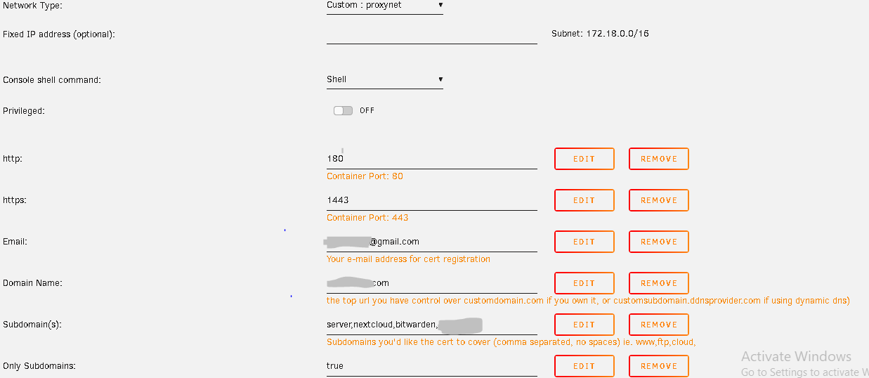

first, I know that Letenrypt is set up right with my domain name and subdomains, the log connected to all my  subdomains: Nextcloud, bitwarden. see image. made sure the Cnam is set right spelled right...

now the weird part. when i use http://bitwarden.mydomain.com it will direct me to nextcloud i don't understand why?, when i stop nextcloud and try again i have error 502 Bad Gateway nginx/1.16.1
i am able only to connect locally with bitwarden i dont know what am i missing. this was the same using duckdns as domainCapture.thumb.PNG.99f93f1d4fb26488d557e0fce99115b6.PNG
