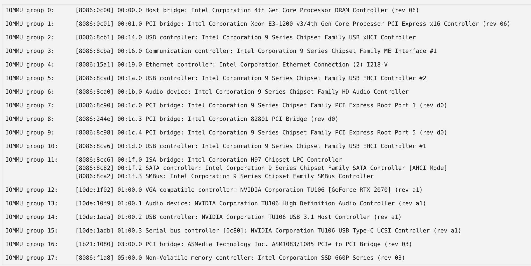

Hello, Im new to unraid.
First first target is passthough my nv rtx 2070 to WIn and Ubuntu(Only one system will be run at the same time).

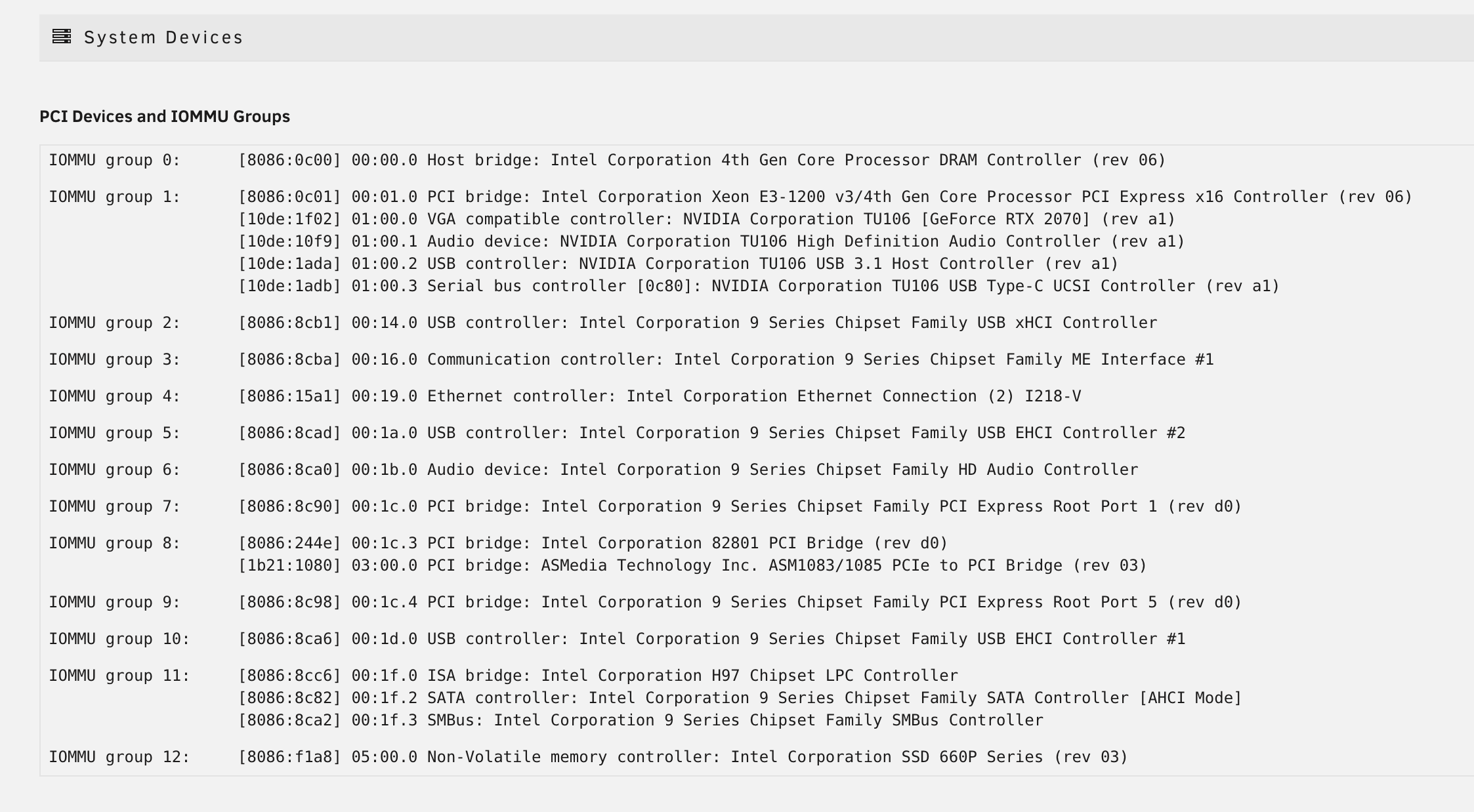

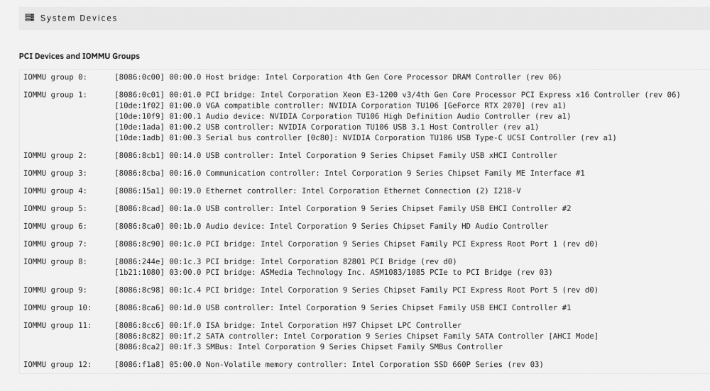

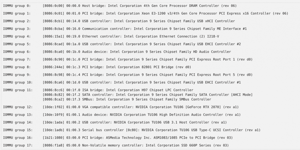

My origional IOMMU group showns as imageproxy.php?img=&key=e5eec7c5c933ca16:

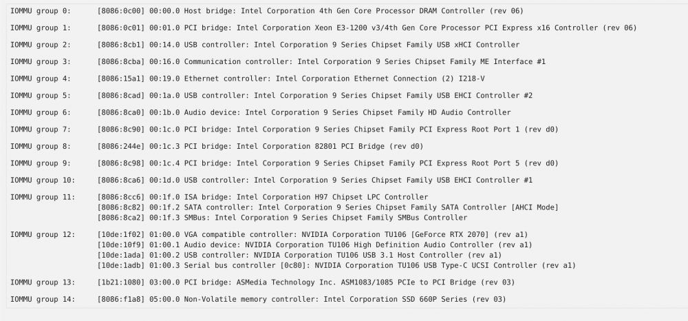

Basied on my understanding from youtube videos below, my IOMMU group 1 may not look right, so I switch to PCIe ACS override-downstream and got IOMMU group 12 which looks right to me.

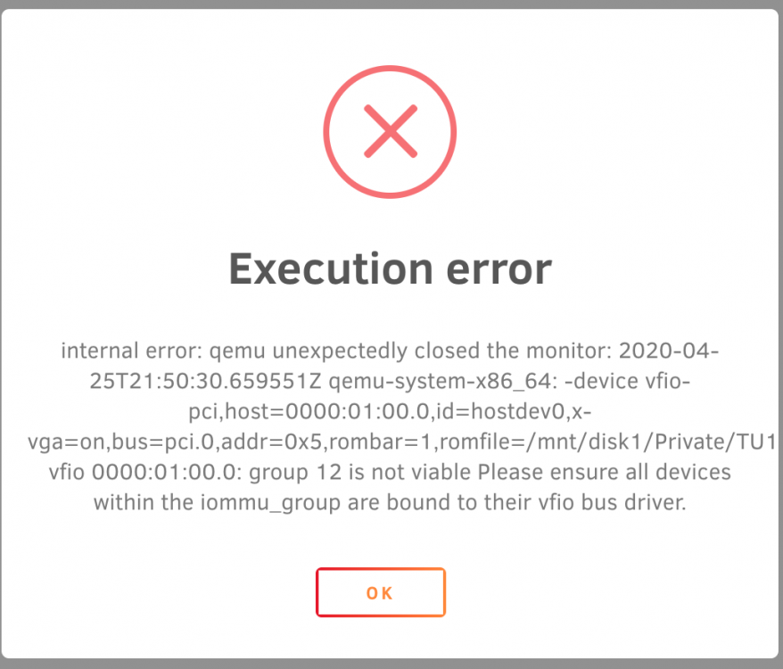

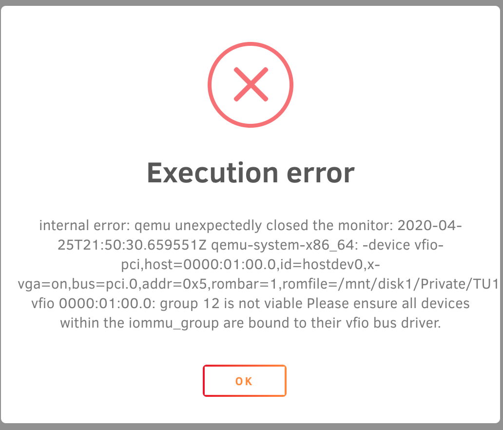

Then I got error:
imageproxy.php?img=&key=e5eec7c5c933ca16Error.thumb.png.e76b7e8553239496c78e08b9b58a1477.png
Afterwards, I update my Unraid OS to the following :
kernel /bzimage
append pcie_acs_override=downstream initrd=/bzroot vfio-pci.ids=10de:1ada,10de:1adb
The error goes away.

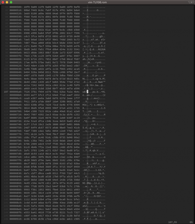

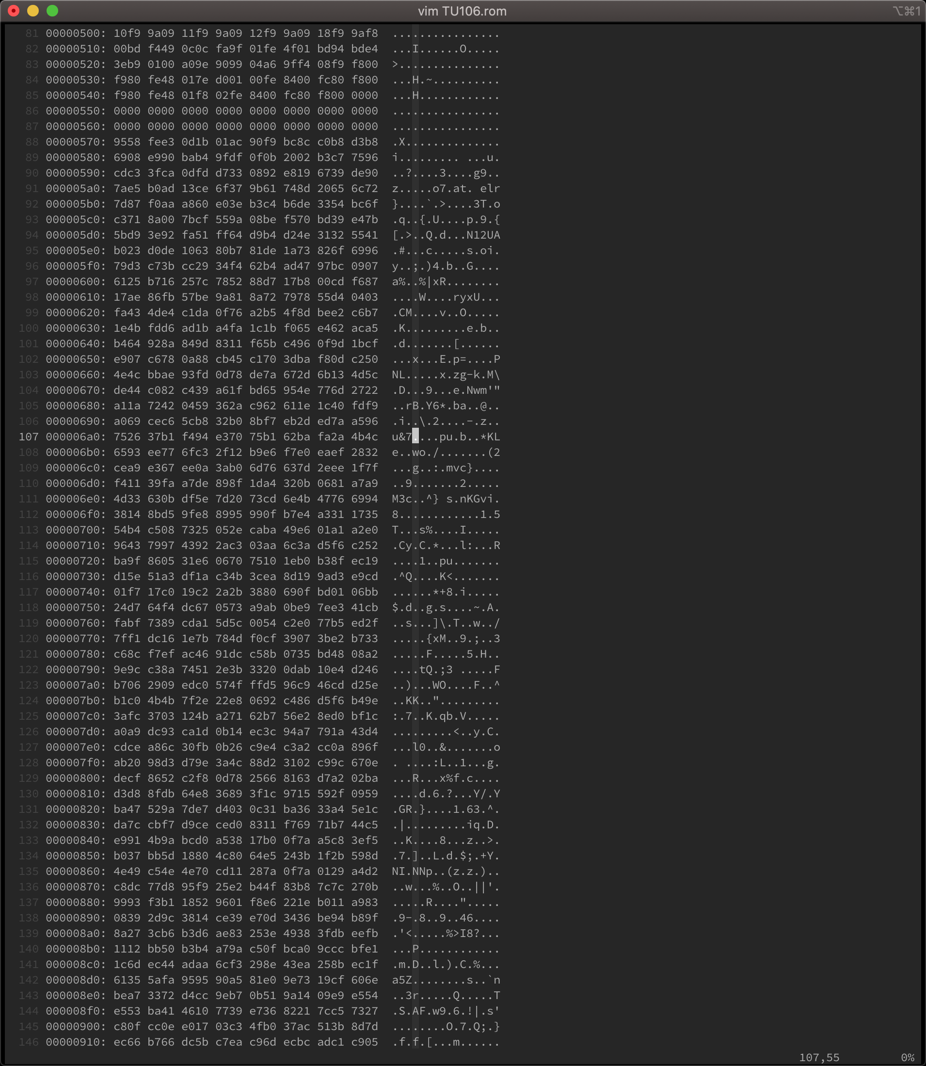

The rom Im using right now is extract from GPU-Z
I also tried remove header by myself
The only line I can find from rom that starting with 'u' is line 107. So I removed the line 1-106
However, NONE of my attempts works.

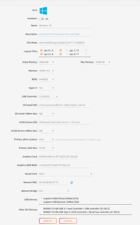

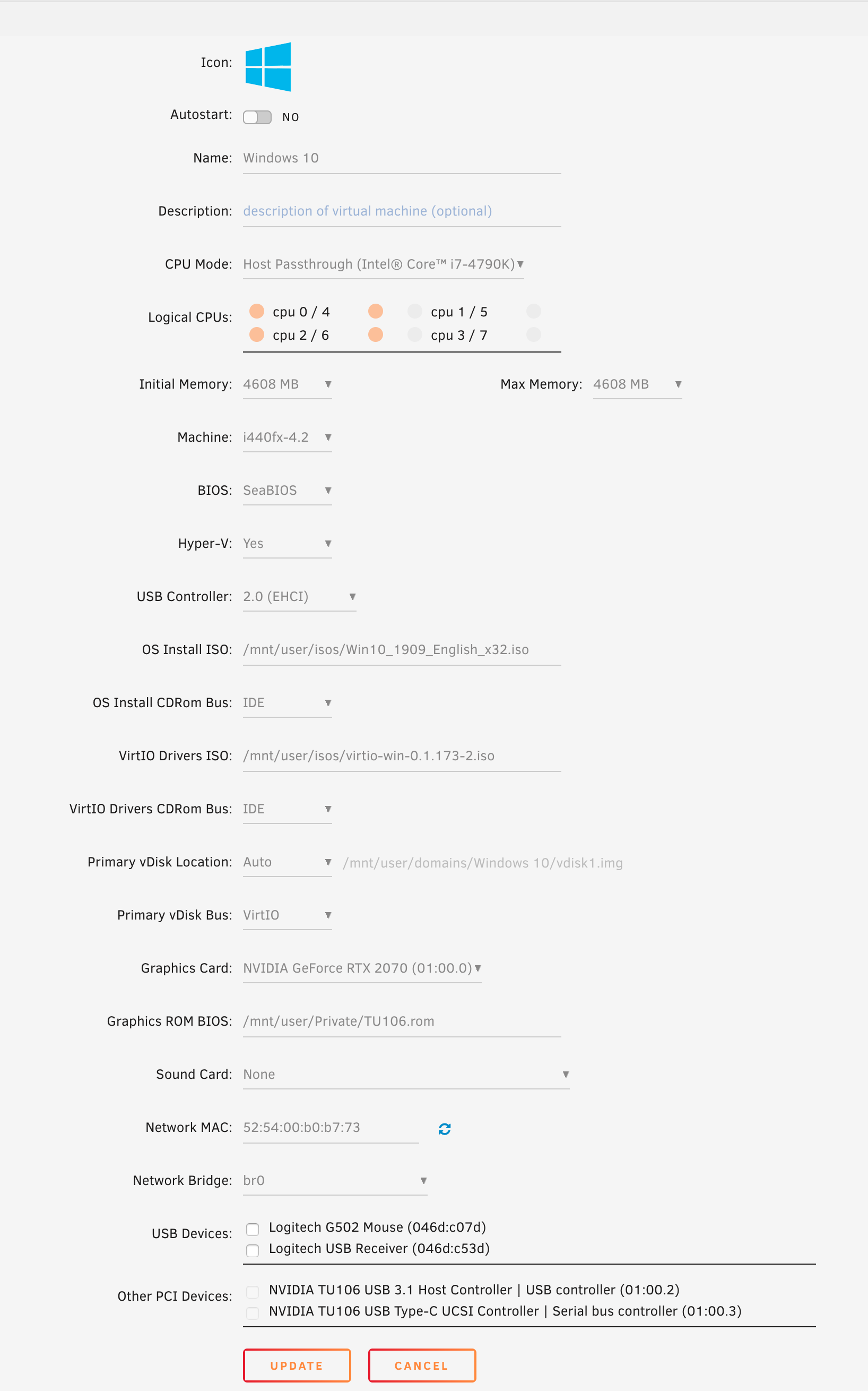

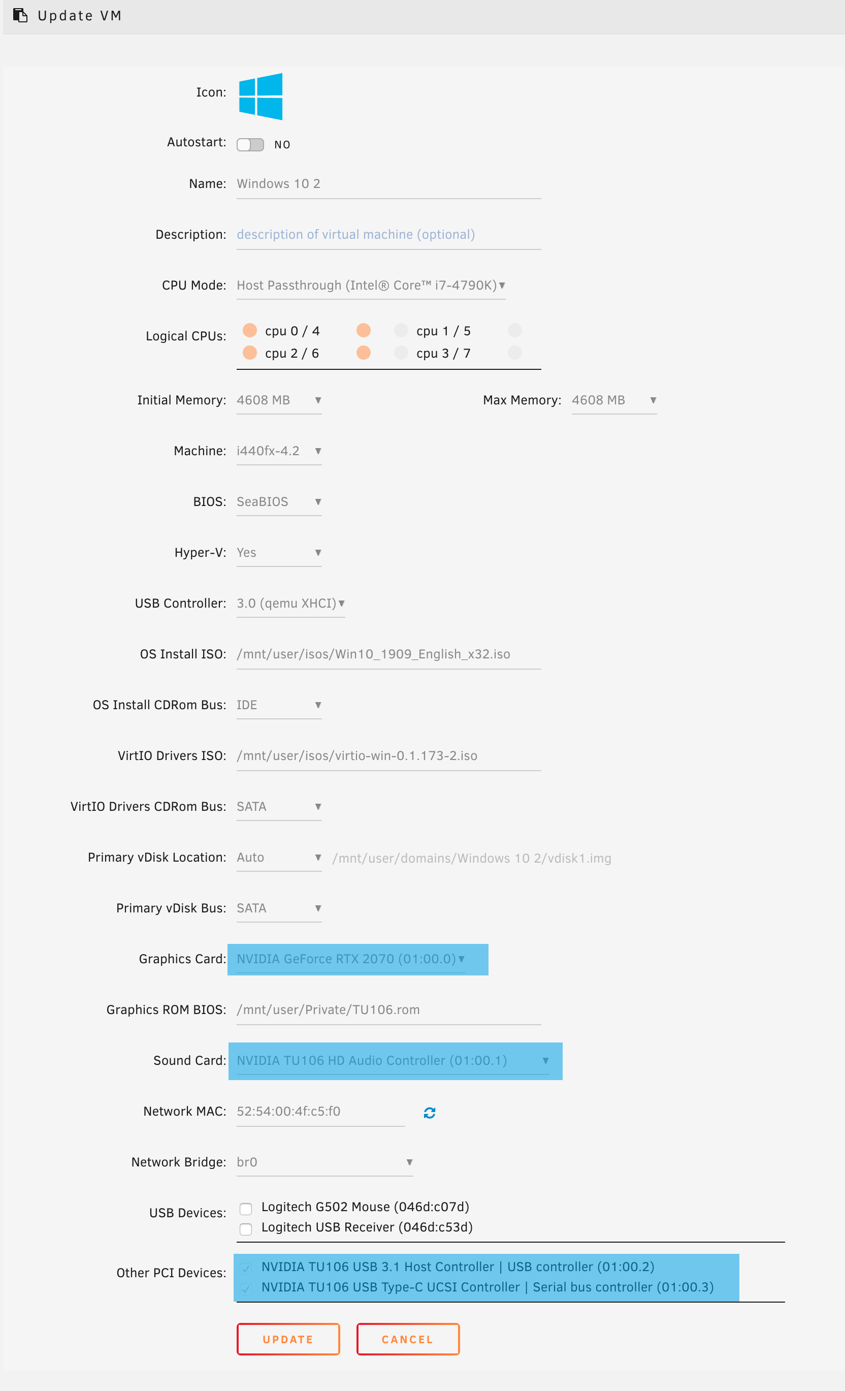

My Win 10 config:

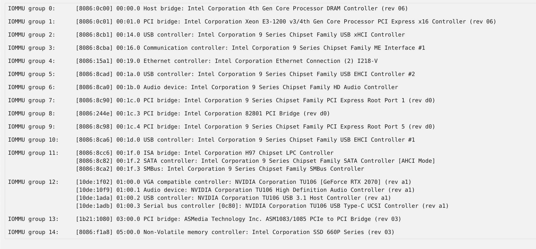

Hello, you were close when you got the Group 12 that I quoted from your post HOWEVER you were trying to only passthrough your RTX 2070s usb-c controller.
vfio-pci.ids=10de:1ada,10de:1adb are your USB 3.1 controller and serial bus on your 2070. You need to be passing through the VGA Controller @ 10de:1f02 and your GPUs audio @ 10de:10f9. Also you must passthrough everything in group 12 including the RTX USB-C controller you were trying to passthrough before.
Your vfio-pci.ids should look like this...
vfio-pci.ids=10de:1f02,10de:10f9,10de:1ada,10de:1adb
Once you do that make sure you select everything listed in Group 12 to passthrough in Unraid VM Win10 config PCI Devices.

Hi @Carbongrip
Thank you very much for the posting!

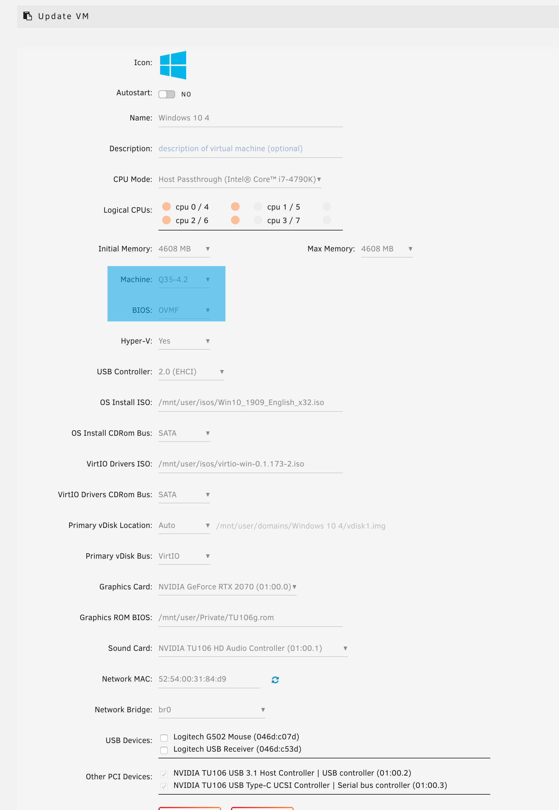

I've updete vfio-pci.ids all group 12 and pass them into VM(as screenshot)
But I still got a black screen :(
Do you think this may related to gpu vbios ?
Thanks!
Wait you need to set BIOS to OVMF and Machine to Q35.
Edited by Carbongrip
OVMF does not work somehow.. I tried it with VNC it was on UEFI Shell window. SeaBIOS worked with VNC.

Remove the vbios and boot without it. Its not a requirement and is optional.
Still no luck :(
