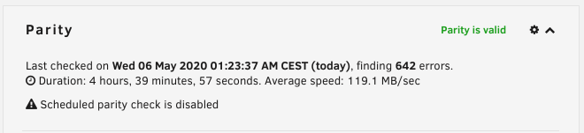

I then started the array in maintenance mode and started a parity check. 640 Errors were found and corrected.

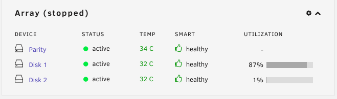

Now i still can't start the array (it get's stuck on starting services) without maintenance mode and the btrfs errors didn't change (logs are attached)
I can acces my Filesystem and all files seem OK, but i can't use the array normally.

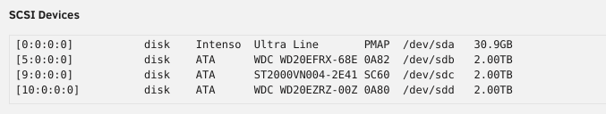

Server Specs:
AMD Ryzen 5 2700 (8 Cores, 16 Threads)
16 GB RAM DDR4-3000 (2x8GB)
(i tried to add 16 GB DDR4-3200)
3 x 2TB HDD Drives
No cache
I have 40 Dockers and one VM.
