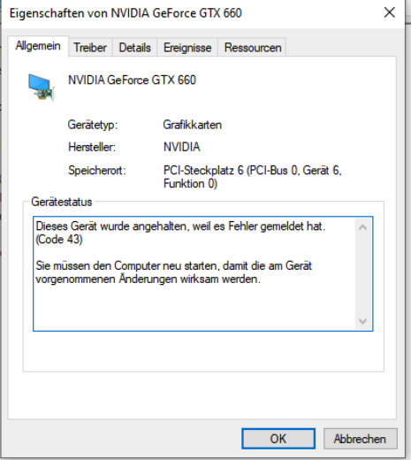

Unfortunately I have a problem with passingthrough my graphics card - I have an Nvidia Quadro 2000 GPU in the first PCie slot and a GTX660 in the second PCIe slot. Unfortunately I am unable to pass the GTX660 graphics card through to my Windows 10 VM.
It is recognized and the Nvidia driver can also be installed - but unfortunately the card subsequently crashes with the Error Code43.
I have already tried everything and tried all possible instructions.
Attached my VM Win10 Config + Diagnostics

Hopefully I can be helped.
best regards
