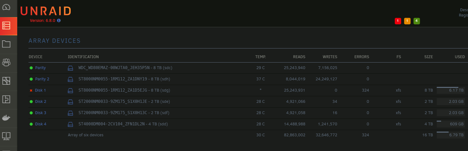

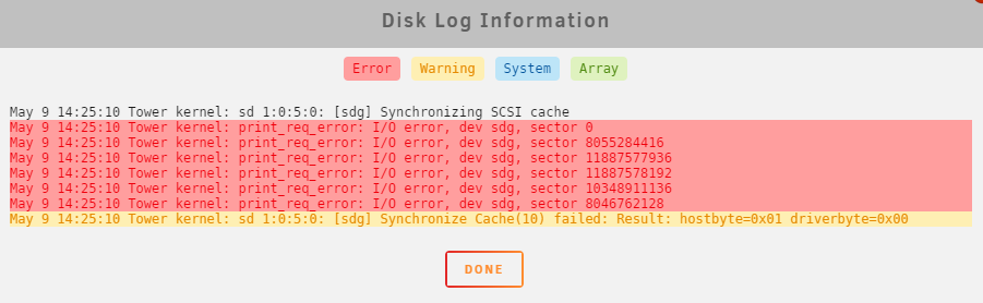

After all of this, and switching to the HBA everything has been fine for a couple weeks again. BUT today i received errors that my main data disk is disabled after encountering errors. At this point i have no idea what is causing issues since it has been for 3 different drives in different bays. Can someone help me troubleshoot this? I attached some screenshots and log files. Please let me know if there is anything else I can do.
tower-diagnostics-20200509-2103.zip tower-syslog-20200510-0104.zip
Looks more like a power/connection issue, swap/replace BOTH cables (or slot) and rebuild on top.
I swapped the drive into a different bay. was able to rebuild the disk in Unraid with no problems. So far recovering from these disabled disks has been fine but i dont want this to keep happening roughly every two weeks. I read that it may help to clean all the contact points for power and my SAS breakout cables with isopropryl alcohol. I will do that this week and hope for the best.
