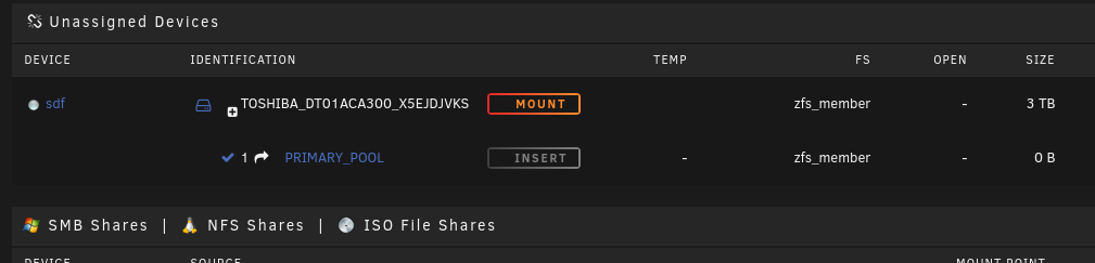

Ok so before i attempt to mount this. Does this look normal to you? I expected file system to be xfs not zfs_member
bac26
I did get an odd error when i tried to mount the drive from the command like in order to back it up.
root@NAS:/# mount /dev/sdf1 /mnt/recovery
mount: /mnt/recovery: more filesystems detected on /dev/sdf1; use -t <type> or wipefs(8).
As a result i had to specify the file system manually in order to mount the drive.
root@NAS:/# mount -r -t xfs /dev/sdf1 /mnt/recovery
Is this normal or am i looking at possible file system corruption?
Edit: This drive was part of a ZFS pool before i switched to unraid and reformatted everything.
Edited by brandon3055
Not normal but likely the disk was used with zfs before, xfs partition is still mounting correctly, check contents look correct, don't forget to unmount before the new config.
