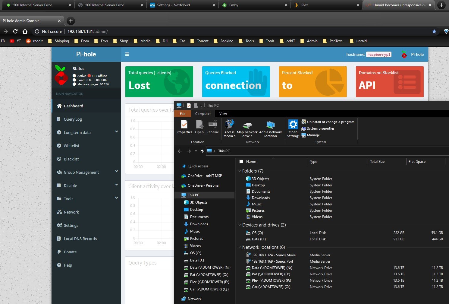

My management UI is dead, cant resolve it, both tabs on top show the local UI, and one through a DDNS. all other tabs show containers that run off the same IP but use a different port. They all work when accessed locally or remotely.  All of the shares are online and as for the Pi, well its status is the same as last night, even if i had it upgraded in between to Pi-hole Version v5.0 Web Interface Version v5.0 FTL Version v5.0.
To remove the pi from the equasion, I stopped any DNS through it and set it all back to how it was. That only affected the fact that the IP of the main UI now shows up in my Unifi client list as before it didnt.
Right now, most of my logs point to a Bind problem, not a Bond like you...will update this with some data after a little siesta
OK. Investigation over, case closed.
BURN THE PI!!!
V5 V5 V5 and this FTL offline bs could not be dealt with, so i purged all DHCP and DNS data from my pi, then my USG and APs using the CLI, no more issues at all. I will maybe revisit the pi some day, for now, it seems to be too much of a work in progress to run a semi business/ semi host and data center for my customers to bother dealing with something a Ublock Origin extension seemed to do better if what you want is a mostly ad free surfing experience.
