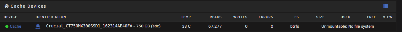

Your cache is corrupt and you should forget about getting dockers going again until you fix that.
Post a screenshot of Main - Cache Devices
Damn cant believe i missed that. I recently swapped out to a new cache drive too. Started completely fresh a couple weeks ago. Any chance i can get the filesystem working?

Do you have a backup of cache?

yeah ive got a backup, you think I should wipe the cache and start over?
That would be simplest. Disable dockers and VMs for now since there may be some additional cleanup needed. Just get appdata restored to cache and post new diagnostics.

Alright, docker and vm service are off, formatted cache, here are the new diags:
