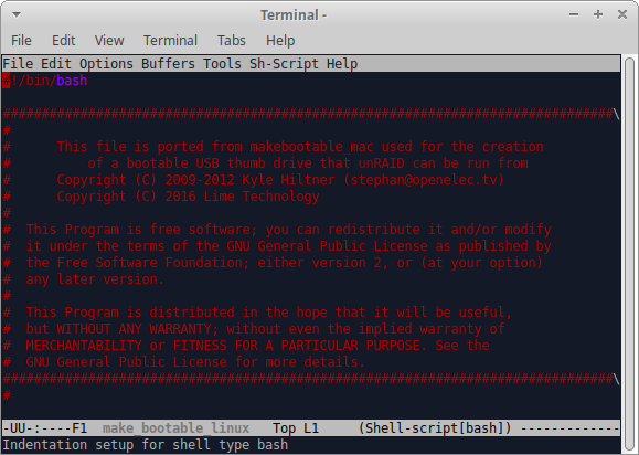

I tried to unzip the backup and tried to use the make_bootable_linux that it has. The screenshot attached is what I am getting after issuing the sudo bash.

Recreate the flash drive and restore the config folder, I'm not familiar with the linux make_bootable, if you can get your hands on a Win10 PC you can use the USB tool which makes it easier.
