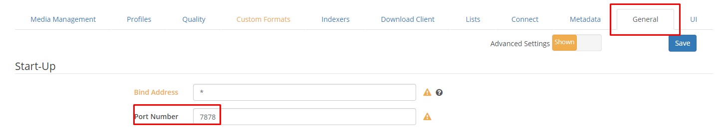

From what I've read online, to change the container port, you have to login and change the port directly via the Radarr or Medusa etc. So in Radarr/Sonarr:
I tried this though and couldn't access the WebUI anymore even though I've added the relevant ports under my rTorrentVPN docker. I decided it wasn't worth the hassle when I can just run one more torrent docker which uses barely any CPU/RAM when idling.

4. Download another of the same container from CA (Note: don't do what I did and recreate from the original template or you'll have issues with Rebuild-DNDC after due to matching container IDs). Do the same setup again for the second container, call it something different, and set the /config Path to a separate appdata folder from the first one. Enable advanced mode and in the WebUI field, change the port number here to be the second port number (in my case, 8990)
5. Stop the first container, and start the second one (with the non-default port). Navigate to the default port WebUI page (192.168.X.X:8989 in my case, NOT 8990)
6. Change the port in the container settings to be the secondary port you want to use. In sonarr's case, Settings -> General -> Port Number -> 8990. Save and restart the container
7. Now start the first container, and check if you can access them both via their respective ports
