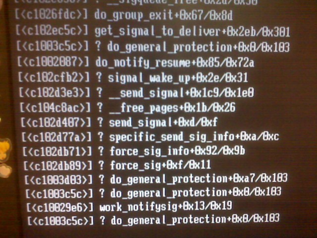

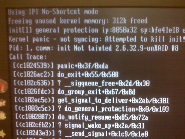

I was copying some files into the unraid server and suddenly it was unresponsive. The only thing I can do is to reboot. But each time I see this error message on the console (see attached pictures). It says kernel panic.
Didn't know what happened, I also pulled the flash drive to check on another computer. Now when I reboot, I am stuck at "Verifying DMI pool data....."
I have tried using another flash drive (with uinlicensed) and bios flashes, nothing works. I think I have 2 problems now; Kernel panic and DMI error.
Updated: When I unplugged all the SATA cable from the Mobo, unraid loaded but went back to Kernel Panic screen and stuck again.
Please provide any suggestions I may take next. Help, I am stuck!

First run a memory test, preferably overnight.

This time, I stopped the loading of Unraid OS and and did the memtest.
-Results were full of errors
-Started troubleshooting to isolate the bad memory and found one stick which is bad.
-Pull bad memory out and left with 3GB
-Reboot and everything loaded
