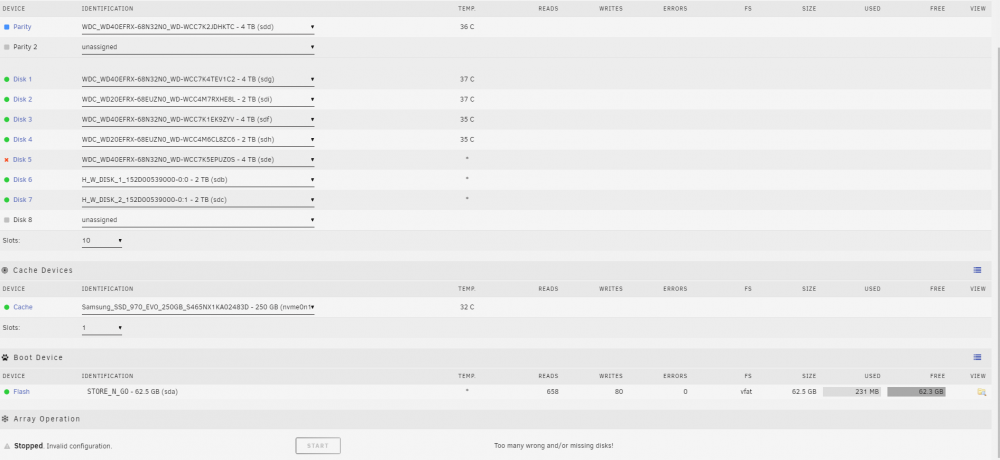

So I was upgrading my parity drive to a bigger one, from 4TB to 8TB. Everything was working well on the array before the upgrade.
I shut down the server, took out the parity drive and replaced it with the new one and started the server.
I chose the new parity drive for the server and started the rebuild. As soon as the rebuild started another HDD failed.
I tried switching the parity drive back but the server would not take it because it thinks it is a new drive. (see screenshot)
Is there anyway to make the server forcefully accept the old parity drive so I can switch the failed drive with a new one to rebuild it?

It's possible to re-use the old parity (but note that unless you did the rebuild in maintenance mode it will be a little out of sync due to mounting all the disks, though usually not a big deal) but the disable disk looks fine, most likely a connection issue, do you have the logs from when it happened?
I sadly don't have the logs. How ever I switched both the power cable and SATA cable with a working drive and that made no difference. How would I make unraid accept the old parity drive?
