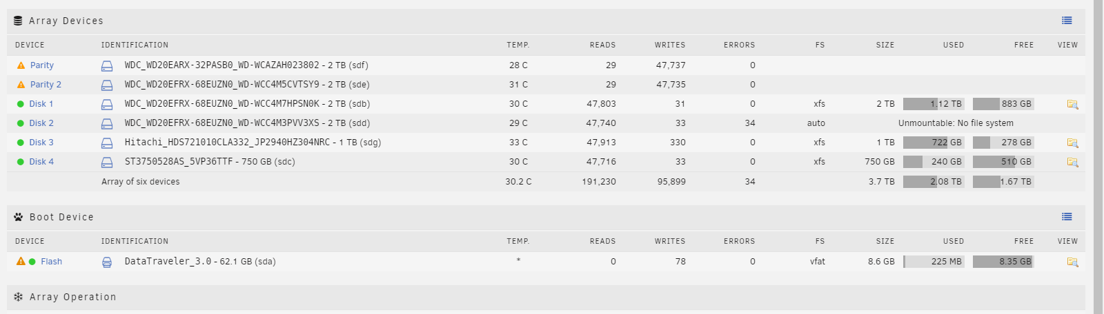

Try that and post a screenshot of Main - Array Devices.
Okay, here is where we got to. I mounted all drives as data at first and like you said, 2 didn't show filesystems, so I added those as the parity drives, and started the array. Now another drive showed up as unmountable :(. Any suggestions?
Nevermind on the drive. it just took unraid a few hours to figure everything out, and it is rebuilding the array! Yay for no data loss!
