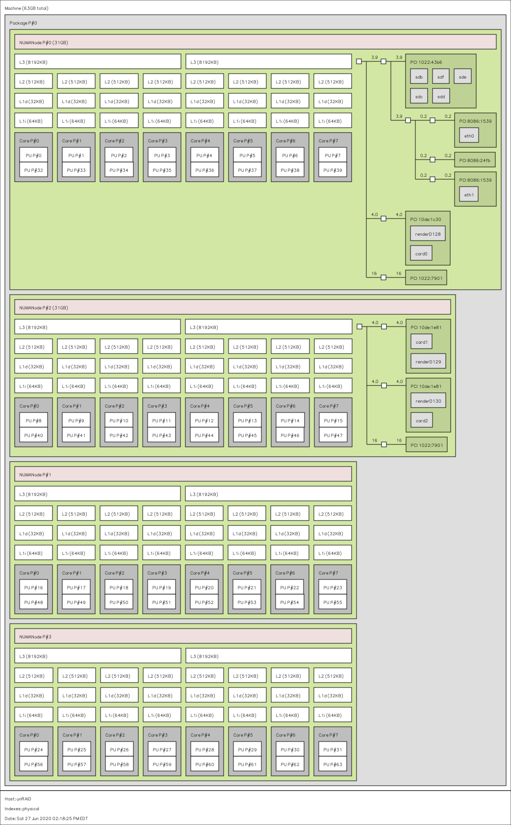

July 7, 20206 yr 51 minutes ago, commotion said: Ya im at a total loss here would love for this to work well on this cpu. I might have to switch back to Intel.. I'm on my phone right now but I'll look over this next time I get to my desk. Looking at the picture you posted it appears your using a 2990wx correct? It can be slightly difficult to say the least. Edit saw the parts picker thing. So yeah 2990wx. It only has two numa so it will make it all fun. Edited July 7, 20206 yr by Jerky_san

July 8, 20206 yr @commotion Below you'll notice a few things <emulator pin <numatune> <- right below emulator pin <numa> Honestly I'd suggest just copy/pasting what I have for the vcpu allocation/emulatorpin/numatune part. Then on <numa> adjust it for how much ram you have in each "side" of the double memory. I had 128gb in this host so I had 16gb from each channel allocated. You CURRENTLY have 16gb allocated total so just take my numbers and divide them by 2 and boom done on that part. Under <features> are also some nifty things to use. DO NOT copy EVERYTHING such as <os> cause that will break your machine. Anyways the reason you probably want to copy most of it is because my config spans two numa nodes that have memory controllers thus you'll get the fastest you can get(unless you want to allocate 4 cpus from each numa). You'll not get a huge performance boost from doing that though unless it is VERY SPECIFIC WORK LOADS!!! Quote -i also have a unknown device with the hardware id of APCI\VEN_APP&DEV_0005. (I've tried search this online and alot of people didn't have a answer. I tried searching on the virIO disk) Where is this device? Inside the VM? Install the agent from the virtio iso if so. Quote I've ran each for years.. but id rather just run unraid. Consider trying it if you don't get the performance your looking for. The only problem I have right now is it doesn't properly do the ram as much as I'd like but I don't have to "allocate" cpus or anything. Just "works" Lastly just to ask.. is there a reason you choose the 2990wx over say a 3950x? <- this is just my curiosity and doesn't require any explanation if you don't want to. <cputune> <vcpupin vcpu='0' cpuset='4'/> <vcpupin vcpu='1' cpuset='36'/> <vcpupin vcpu='2' cpuset='5'/> <vcpupin vcpu='3' cpuset='37'/> <vcpupin vcpu='4' cpuset='6'/> <vcpupin vcpu='5' cpuset='38'/> <vcpupin vcpu='6' cpuset='7'/> <vcpupin vcpu='7' cpuset='39'/> <vcpupin vcpu='8' cpuset='8'/> <vcpupin vcpu='9' cpuset='40'/> <vcpupin vcpu='10' cpuset='9'/> <vcpupin vcpu='11' cpuset='41'/> <vcpupin vcpu='12' cpuset='10'/> <vcpupin vcpu='13' cpuset='42'/> <vcpupin vcpu='14' cpuset='11'/> <vcpupin vcpu='15' cpuset='43'/> <emulatorpin cpuset='4-11,36-43'/> </cputune> <numatune> <memory mode='strict' nodeset='0,2'/> <memnode cellid='0' mode='strict' nodeset='0'/> <memnode cellid='1' mode='strict' nodeset='2'/> </numatune> <os> <type arch='x86_64' machine='pc-i440fx-4.2'>hvm</type> <loader readonly='yes' type='pflash'>/usr/share/qemu/ovmf-x64/OVMF_CODE-pure-efi.fd</loader> <nvram>/etc/libvirt/qemu/nvram/99642e81-2f13-a916-682c-90191636d75f_VARS-pure-efi.fd</nvram> <boot dev='hd'/> </os> <features> <acpi/> <apic/> <hyperv> <vpindex state='on'/> <synic state='on'/> <stimer state='on'/> <reset state='on'/> <vendor_id state='on' value='KVM Hv'/> <frequencies state='on'/> </hyperv> </features> <cpu mode='host-passthrough' check='none'> <topology sockets='1' dies='1' cores='8' threads='2'/> <cache mode='passthrough'/> <feature policy='require' name='topoext'/> <numa> <cell id='0' cpus='0-7' memory='16777216' unit='KiB'/> <cell id='1' cpus='8-15' memory='16777216' unit='KiB'/> </numa> </cpu>
