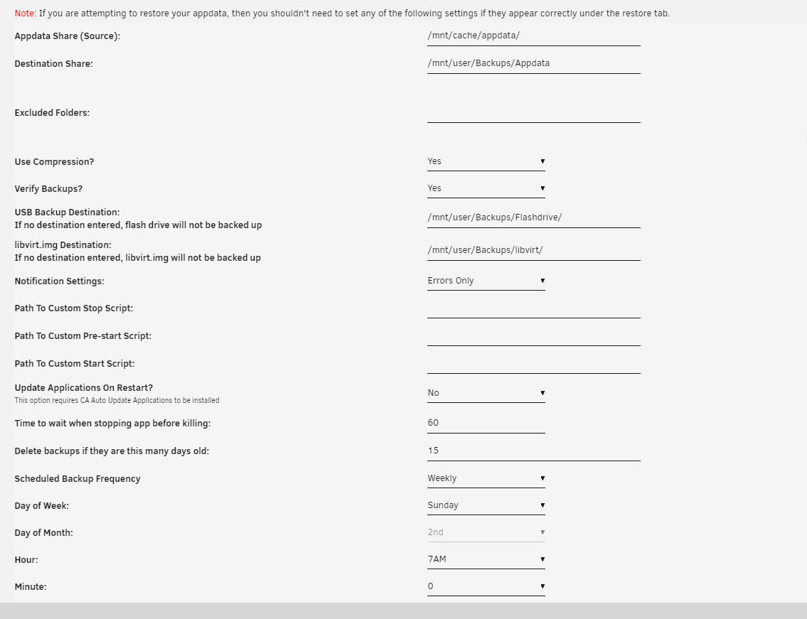

ps, check the image, for you the CA backup is setup correcly?image.thumb.png.d489537b61da8f8b5fe42aefa8f64144.png
many thanks again!
3 minutes ago, forbi said:
i have the directories  Backups\Appdata\[email protected] and Backups\flashdrive on my disks and those 2 should have the files i eventually needs for restore the dockers, right?
Yes. Probably you won't need the flash backup in this case, but good to have.
