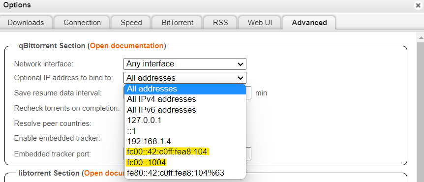

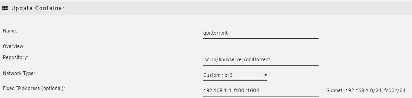

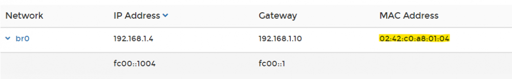

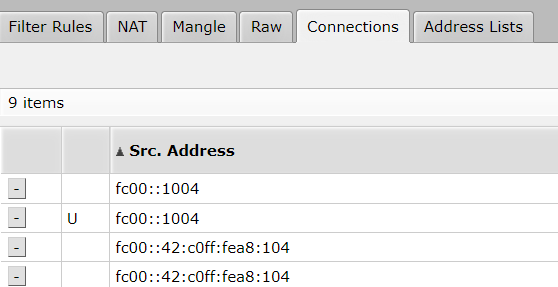

December 21, 20214 yr Similar issue here, I deploy a qbittorrent with static IPv6 [fc00::1004]. However, it will always automatically assign an additional IPv6 (related to MAC address). By checking my router's connection, these two ips are both active. my question is, how to disable one of these two ips
