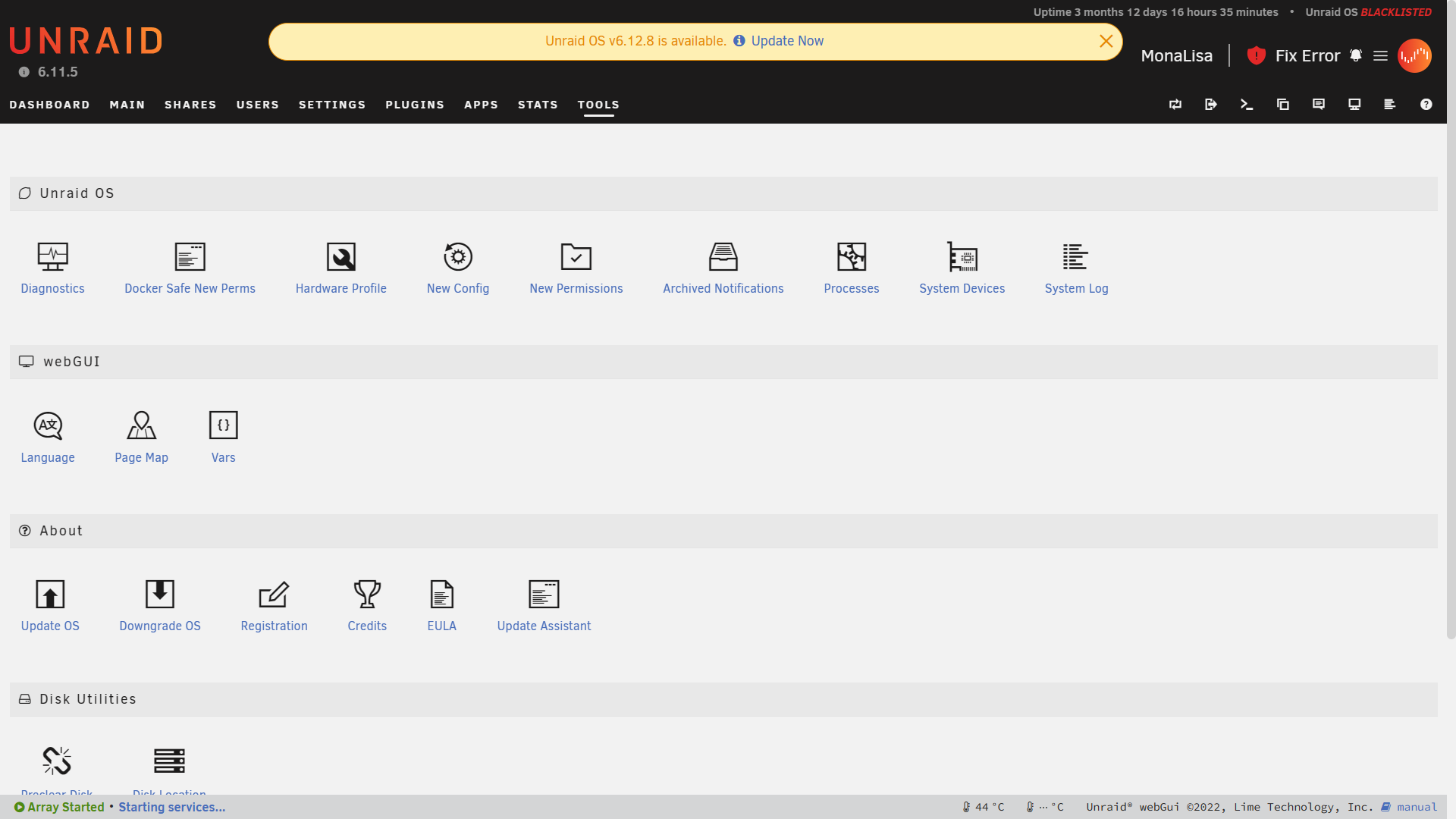

  11. I managed to bypass the broken menu and to go directly to the Url of diagnose page, it worked. Here is the diagnostic. Sorry for the time lost monalisa-diagnostics-20240327-1924.zip

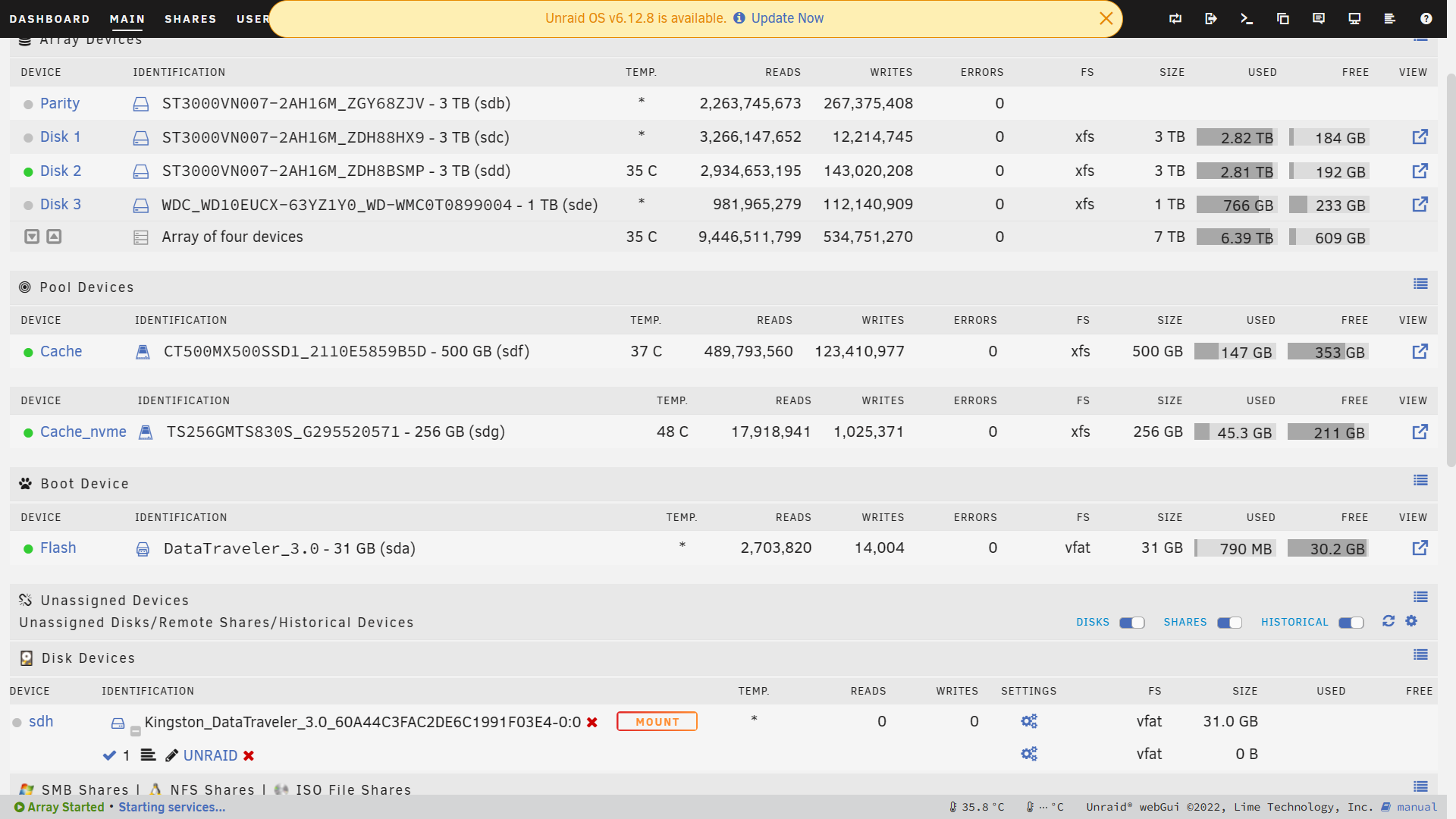

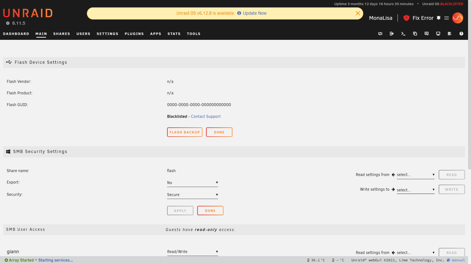

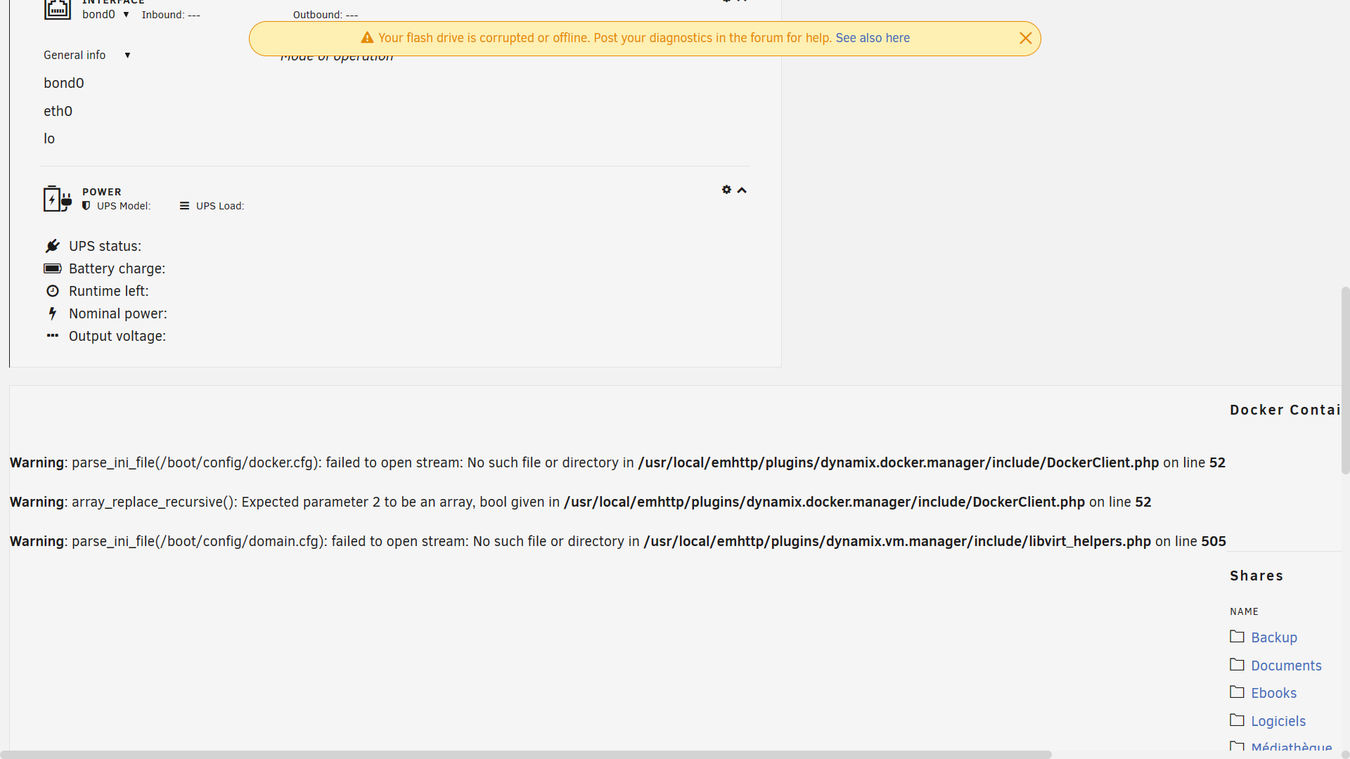

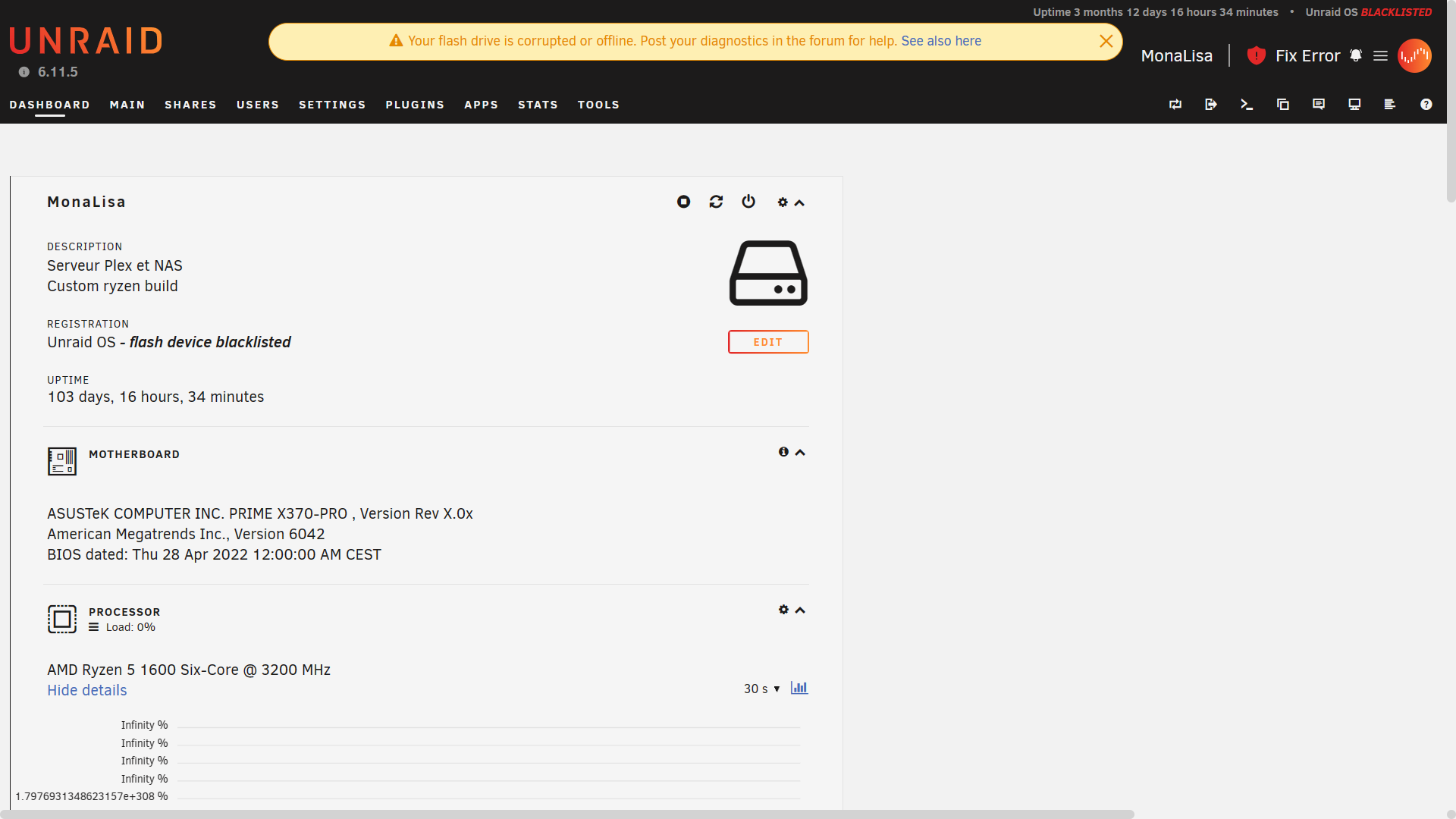

  13. Hi all, Accessing the Web UI, I noticed today some big troubles in my server. I do not live in the same location, so I don't know when it started. The webUI is off, displaying failed to open stream everywhere, most of options and pages are unavailable (I cannot access diagnostic or logs through UI). The USB key seems to be blacklisted OR offline, but I wanted to post here before attempting a reboot or anything. Here are some screenshots. Could you provide me with instructions to diagnose / fix its current state ? I've been running unraid for years without any issue.
