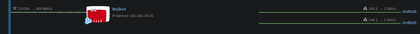

November 8, 20205 yr Hello there, me having similar Problems. Also can't reach beyond ~10MB/s Tried many different settings. No change. Had FreeNas on the same machine with the full speed of my two disks. Best regards Ruben unraid-diagnostics-20201108-2319.zip

November 28, 20205 yr Connecting to host 192.168.178.57, port 5201 [ 5] local 192.168.178.49 port 36468 connected to 192.168.178.57 port 5201 [ ID] Interval Transfer Bitrate Retr Cwnd [ 5] 0.00-1.00 sec 56.4 MBytes 473 Mbits/sec 0 2.66 MBytes [ 5] 1.00-2.00 sec 67.5 MBytes 566 Mbits/sec 0 3.70 MBytes [ 5] 2.00-3.00 sec 65.0 MBytes 545 Mbits/sec 0 3.79 MBytes [ 5] 3.00-4.00 sec 67.5 MBytes 566 Mbits/sec 0 4.01 MBytes [ 5] 4.00-5.00 sec 63.8 MBytes 535 Mbits/sec 0 4.01 MBytes [ 5] 5.00-6.00 sec 66.2 MBytes 556 Mbits/sec 0 4.01 MBytes [ 5] 6.00-7.00 sec 66.2 MBytes 556 Mbits/sec 0 4.01 MBytes [ 5] 7.00-8.00 sec 66.2 MBytes 556 Mbits/sec 0 4.01 MBytes [ 5] 8.00-9.00 sec 65.0 MBytes 545 Mbits/sec 0 4.01 MBytes [ 5] 9.00-10.00 sec 65.0 MBytes 545 Mbits/sec 0 4.01 MBytes - - - - - - - - - - - - - - - - - - - - - - - - - [ ID] Interval Transfer Bitrate Retr [ 5] 0.00-10.00 sec 649 MBytes 544 Mbits/sec 0 sender [ 5] 0.00-10.04 sec 649 MBytes 542 Mbits/sec receiver iperf Done. In my current state, I get ~ 30MiB/s via smb using a manjaro client shouldn't that be more? also made an updated diag file tower-diagnostics-20201129-0210.zip Edited November 29, 20205 yr by ben2000de
November 29, 20205 yr Community Expert Iperf is showing low performance, but yes should be getting more than 30MB/s, though a first you mentioned 10MB/s? Try with another client if possible, like a WIndows PC.
