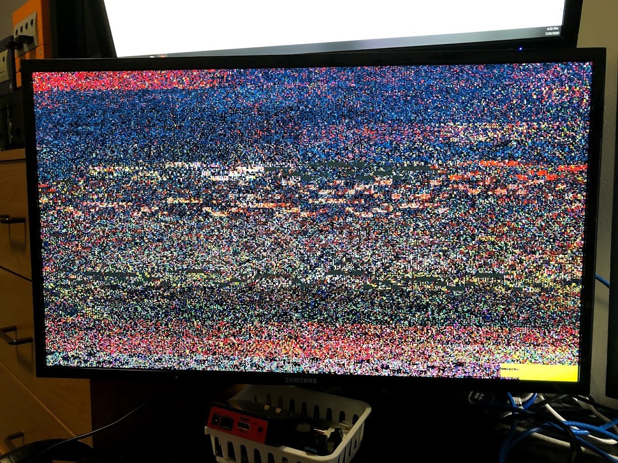

July 23, 20206 yr Hello all, I am attempting to pass-through my Dell HD 7770 2GB graphics card into macOS Catalina. I used Spaceinvade One's video to get started. Everything works perfectly up until booting into macOS after installing, the GPU works well during install. I end up with these garbled/corrupt graphics: I have googled and searched the forum endlessly looking for a solution, no luck so far. I would appreciate any assistance resolving this issue, if possible! What I have tried so far: With and without VBIOS (dumped using GPU-Z) Naturally without shows nothing Confirmed working GPU with Windows 10 VM Confirmed GPU is UEFI enabled with GPU-Z Custom clover bootflag radpg=15 and injectATI radpg=15 results in same error injectATI causes no signal on monitor after boot to OS Verified resolution is 1080p in OVMF and Clover Same issue with Catalina, High Sierra, and Mojave
