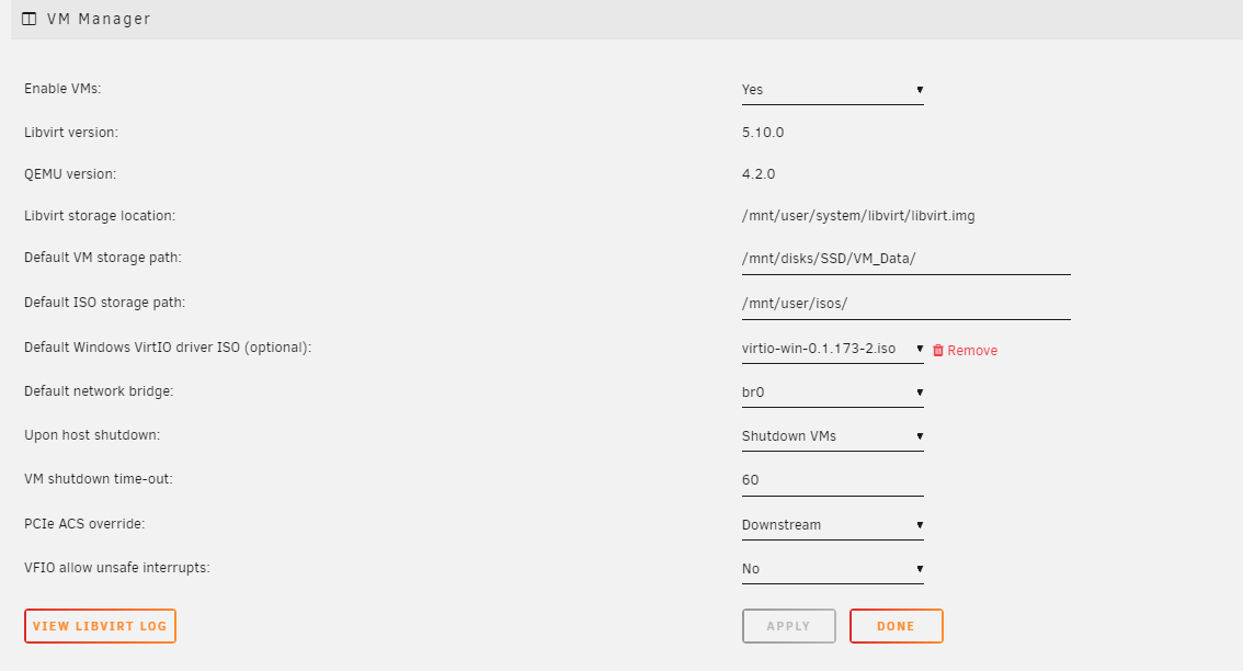

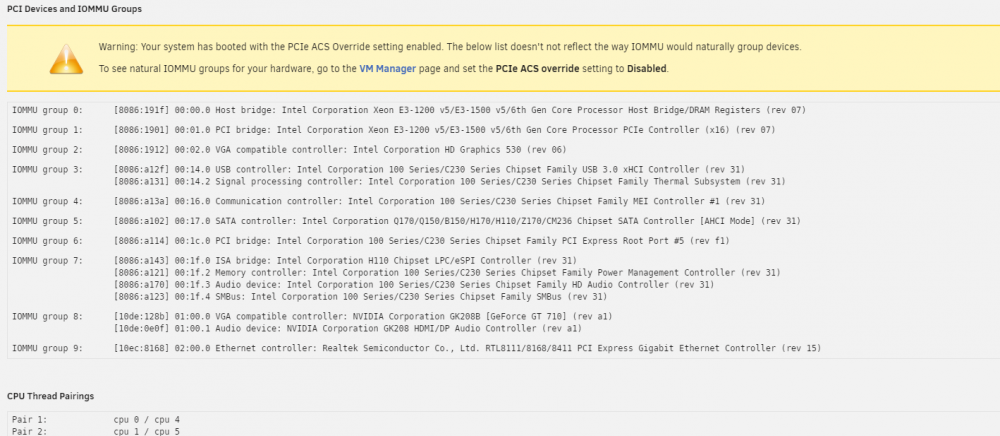

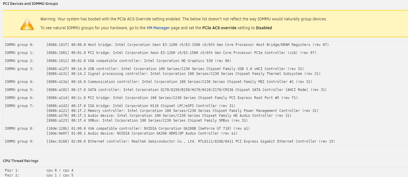

July 27, 20206 yr Author So on all my VM's it doesnt work except for 1 windows 10 VM. I just can't seem to figure this one out: more photos:
