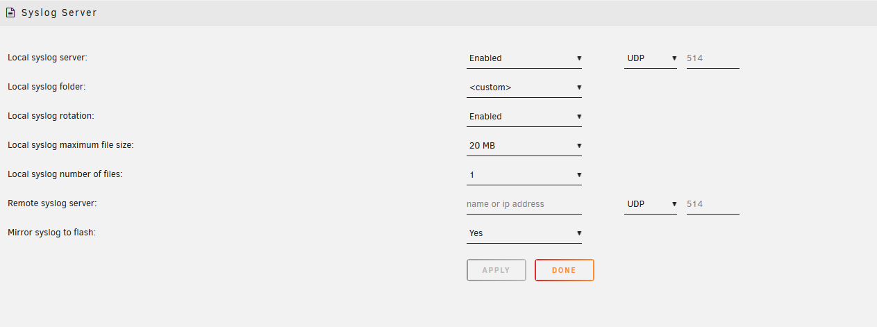

Probably a hardware problem, diags after rebooting won't help much for this, you can try enabling the syslog server.
Ok, does this look correct?
