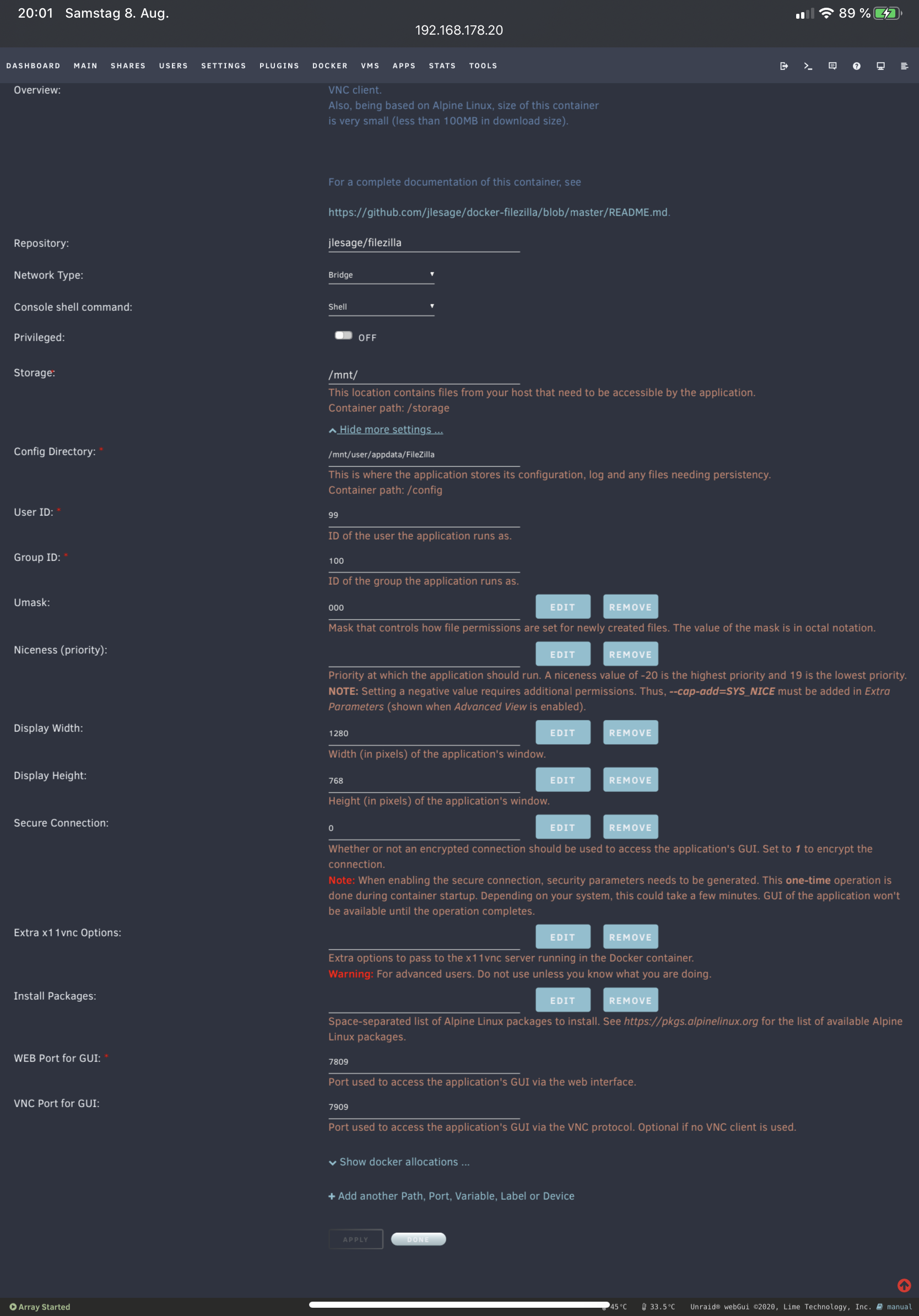

August 8, 20206 yr Author That is an information that sounds good so far. So when I remove the 12TB (disk1) I can Star the array and go on to move the other files from the 2 other disks I want to remove? I use an FileZilla Docker from unraid. How do I move the appdata files from the FileZilla container to one of the remaining disks which will stay inside so that I don‘t have any problems to start the container?
August 8, 20206 yr Community Expert Assuming you are referencing appdata as a user share and not as a folder on a specific disk, and you move that folder from one disk to another, then the container shouldn't know the difference. For more detailed advice, post your diagnostics and the docker run command for that container.
August 8, 20206 yr Author Can I read out the run command from an running container? It is the standard jlesage/filezilla container and I haven‘t changed any configuration like the appdata path which is currently /mnt/user/appdata/FileZilla So I assume that when my copying is finished i can change the container especially the appdata path to /mnt/disk5/appdata/FileZilla which will stay in the system and I can remove the other disks and start the array again and the container will also start as well.

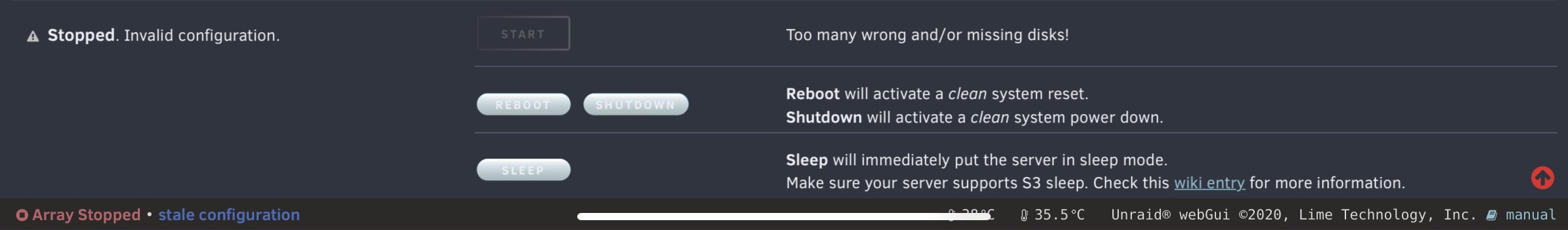

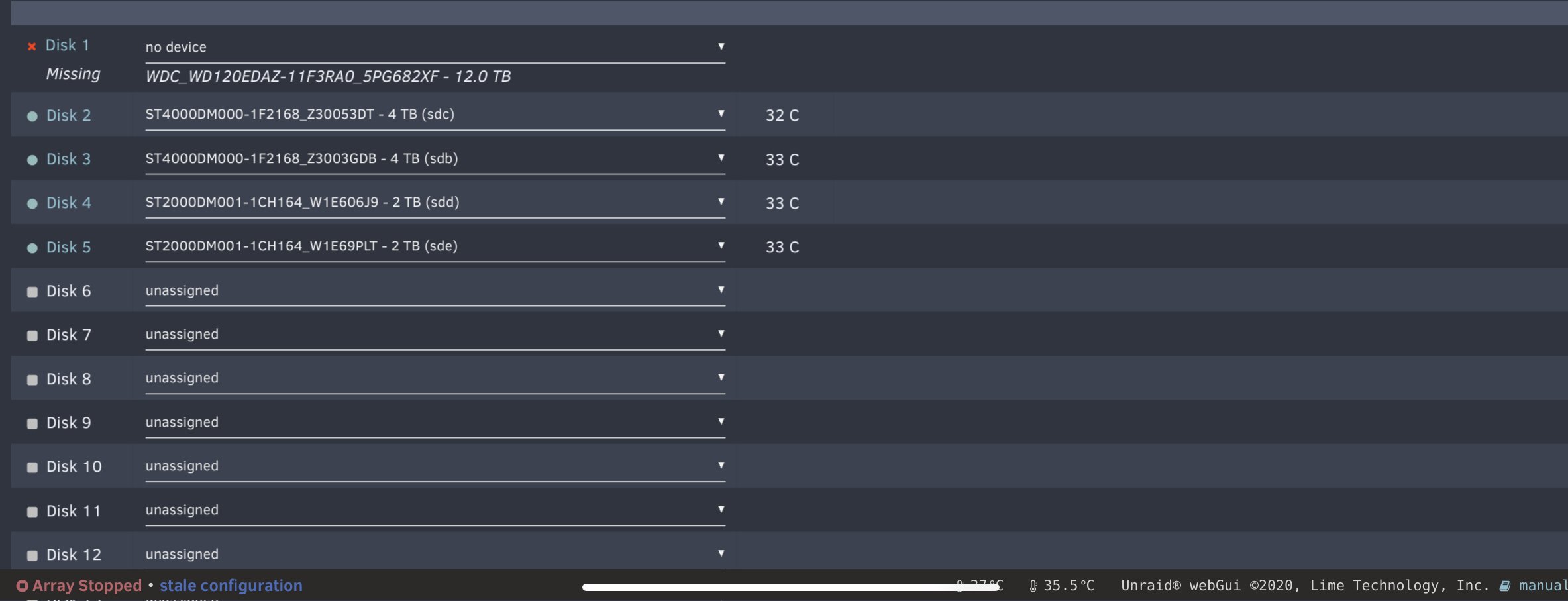

August 9, 20206 yr Author So now I wanted to remove my disks one by one but the array won‘t start because it says that too many disks are missing. How can I now proceed?
August 9, 20206 yr Author Ah i think I found an solution. Will now put the last 2TB on an external drive and will then remove the hdd‘s. i guess this can be closed. Thanks for the advices
