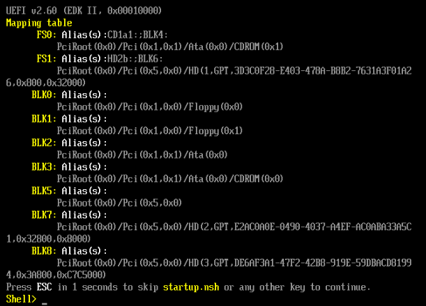

Reset goes through the BIOS startup and boot to DVD option, then back to the UEFI shell

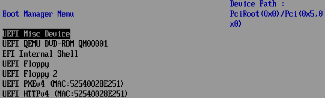

Continue goes to boot to DVD option and then to the UEFI shell
You can see the misc device appears to be the vdisk image yet it won't boot.

Try starting a new template with Q35 machine type. Your template doesn't have virtio iso so I would suggest to keep the virtio ISO connected + make sure you install the right viostor driver. And run ISO images as SATA and not IDE.
If all fail, try a brand new vdisk as SATA instead of virtio. If that also fails then the problem is with the Windows iso.
