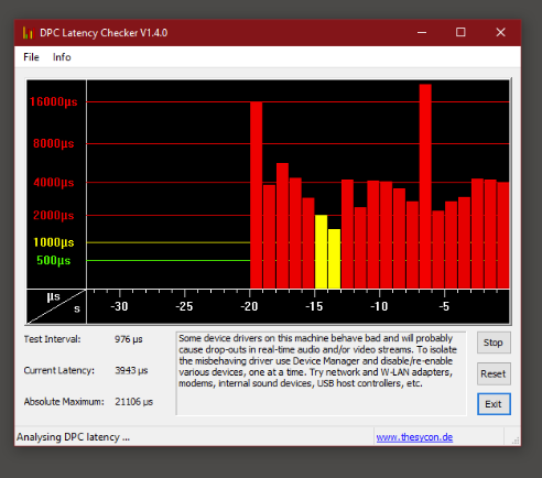

August 17, 20206 yr Hey, Hoping someone can point me in the right direction or offer some suggestions, I have a rig with duel Xeon 5660 and I am having some realy bad cpu lag, as seen below: I have tried disablin multithreading and manually assigning the cores and setting emulatorpin my current cpu tune is: <vcpu placement='static'>4</vcpu> <cputune> <vcpupin vcpu='0' cpuset='8'/> <vcpupin vcpu='1' cpuset='9'/> <vcpupin vcpu='2' cpuset='10'/> <vcpupin vcpu='3' cpuset='11'/> <emulatorpin cpuset='6-7'/> </cputune> I am testing without any passthroughs as well. My cpu assignments are as follows (Note I am hyperthreading is off at the moment): PU Thread Pairings Single: cpu 0 Single: cpu 1 Single: cpu 2 Single: cpu 3 Single: cpu 4 Single: cpu 5 Single: cpu 6 Single: cpu 7 Single: cpu 8 Single: cpu 9 Single: cpu 10 Single: cpu 11 Any help appreicated

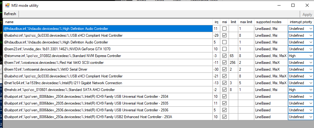

August 17, 20206 yr Did you play around with the MSI mode utility? For me to get video playback to the point it was acceptable on my vm I had to set my sound card and video card to use MSI interrupts and then reboot. Much better and way more stable. See below. It's not perfect, but much better. I still use the SMT threads (6 cores 12 threads) but I'm also on an AMD 3900x. There are threads on these forums disusing this and other solutions to try. MSI_util_v2.zip Edited August 17, 20206 yr by Chess spelling

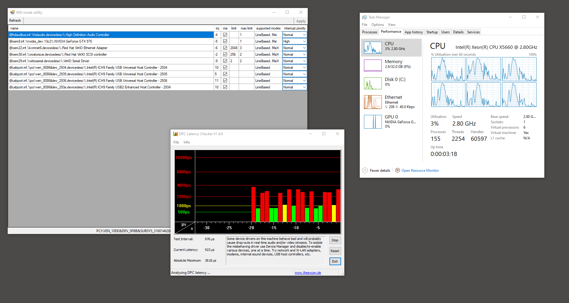

August 18, 20206 yr 25 minutes ago, McKnight said: Hey thanks, I have looked through a lot of other threads and I have managed since posting this, to get some improvement. by setting host mode instead of pass through. It made a massive difference but my latency was still a problem. I have since re-added my passthrough for GPU and USB keyboard. My current config is: I used the MSI untility you send (Thanks for that, I used one from github but it didnt have a gui) and my results now look like this: I'd say it improved things by about 15-20% on my last test. So the utility worked. Do you have any other ideas of how I can get it all under 1000? This is not what you want to hear, but alas no. I still get spikes, but I no longer notice them and games don't studder on me. Let me see if I can find the thread(s) that I used to get here. I also noticed that being on the 6.9 betas made it better, but if you read the second thread you will see that unRaid is not 100% leaving the isolated cores alone, even when the VM is powered down. I'm on the VM right now and in task manager it says that my CPU usage is around 10%, but unRaid is showing all of the VMs used cores around 20 to 25% usage. The 3900x has enough power with some of the fixes in the below threads to "power" through the extra load, but older CPUs might not be able to. It's also worse on Ryzen 2 CPUs at the moment due to a bug in version of quem that the current beta is using and I can't do host pass-through at the moment. I suspect your CPU has Hyper Threading, correct? Hyper Threading can make the issue worse, so while I don't want to say turn off HT, but maybe run a test with it off and see if that improves the situation. The VM is not aware of HT and treats all cores as full CPUs and does not schedule threads properly. I believe you can tell the VM the actual CPU topology (X Cores X Threads) but I never dug too deep into it. I suspect if I did it :right" I'd see some improvement in DPI latency, but I'm at a point that works for me. Below are a few of the threads that helped me get to a playable state. Before doing all this games would studder very badly and was unplayable and for me this system was indented for game streaming, PLEX, backing up physical systems and a number of other minor functions.
